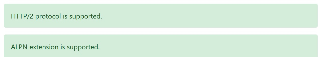

skooogis 7 Posted November 28, 2024 Posted November 28, 2024 Regarding this all connecting clients showing as http/1.1 on my server aswell. Running IIS as reverse proxy. I have verified TLS, both 1.2 and 1.3 are supported and http/2 test also reports supported. Help would be appreciated.
