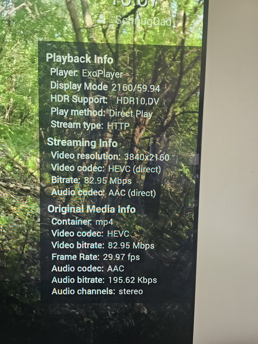

TylerS8271018 0 Posted May 5, 2024 Posted May 5, 2024 well, just to follow up, I output some of the gopro video using H265 from davinci resolve and that also won't play (on the newest version of nvidia shield pro). My server is a DS920+. Here's a picture of the "stats for nerds". My understanding is this should be working okay with direct play?
ebr 16336 Posted May 5, 2024 Posted May 5, 2024 11 hours ago, TylerS8271018 said: Is it possible for me to force a transcode manually? Try selecting "Playback Correction" from the cog menu during playback repeatedly until it plays properly.
