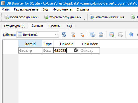

Happy2Play 9799 Posted March 31, 2024 Posted March 31, 2024 It doesn't help if you still have camera upload enabled though as the issue still happens when new items are added. Testing with only one present did not add additional libraries in my test. It is a issue starting with none. But you have to find the ids in the Mediaitems table or the parentid from the url for each library, then remove that id from ancestorids, itemextradata, itemlinks2, useritemshares, then finally mediaitems table. Ensure you have a backup of your library.db though. The ones with the custom path I am not sure as it sound like a old and new config exist. As for files well they have become obsolete as almost all configs have migrated to database only.

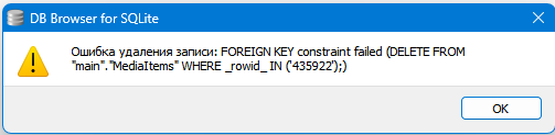

Flest 8 Posted March 31, 2024 Author Posted March 31, 2024 (edited) 56 minutes ago, Happy2Play said: maybe there are faq or something else? ) Edited March 31, 2024 by Flest
Happy2Play 9799 Posted March 31, 2024 Posted March 31, 2024 Just now, Flest said: maybe there are faq or something else? ) That means there is a table with the id still in it so the row can not be deleted
Flest 8 Posted March 31, 2024 Author Posted March 31, 2024 11 minutes ago, Happy2Play said: That means there is a table with the id still in it so the row can not be deleted and how to solve this problem? ) I deleted this from all the tables except "mediaitems"

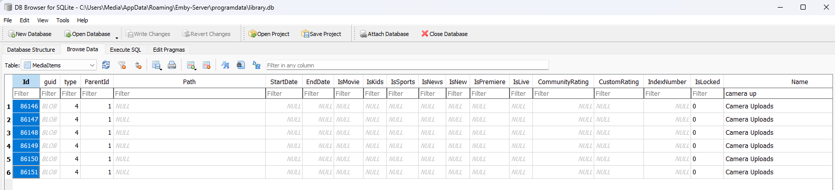

Happy2Play 9799 Posted March 31, 2024 Posted March 31, 2024 This is only an example Now back to the first image for the library as you have linked items to that location. So there is no easy answer here ass all your uploaded images will be linked also preventing the removal of the library. But yes it can be done.

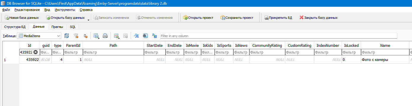

Flest 8 Posted April 1, 2024 Author Posted April 1, 2024 10 hours ago, Happy2Play said: This is only an example Now back to the first image for the library as you have linked items to that location. So there is no easy answer here ass all your uploaded images will be linked also preventing the removal of the library. But yes it can be done. no images, all libraries are empty ok let's try - librory parentId=435922 finded all records "MediaItems" like 439270, 439271, 439272, 439273... delete all from "AncestorIds2" delete all from "ItemExtradata" delete all from "ItemLinks2" delete all from "UserItemShares" back to "MediaItems" and try delete librory, and... i cant ))) save the database and start the server. the libraries are still there, but the folders are gone)

Happy2Play 9799 Posted April 1, 2024 Posted April 1, 2024 (edited) Your images are mixing 43522 and 43523 so it is impossible to say. In the Name column of MediaItems table are you filter cameraupload and then camera upload to see id? Have you filtered the MediaItems Path column for cameraupload to see id? Edited April 1, 2024 by Happy2Play
Flest 8 Posted April 1, 2024 Author Posted April 1, 2024 6 minutes ago, Happy2Play said: Your images are mixing 43522 and 43523 so it is impossible to say. In the Name column of MediaItems table are you filter cameraupload and then camera upload to see id? Have you filtered the MediaItems Path column for cameraupload to see id? numbers are different because these are the numbers of all the libraries that I found) I deleted records of all these numbers Spoiler 435922 435923 435926 439142 439269 439270 439271 439272 439273 439274 439275 439276 439277 439278 439279 439280 439281 439282 439283 439284 439285 439312 439313 439314 439315 439360 439361 439362
