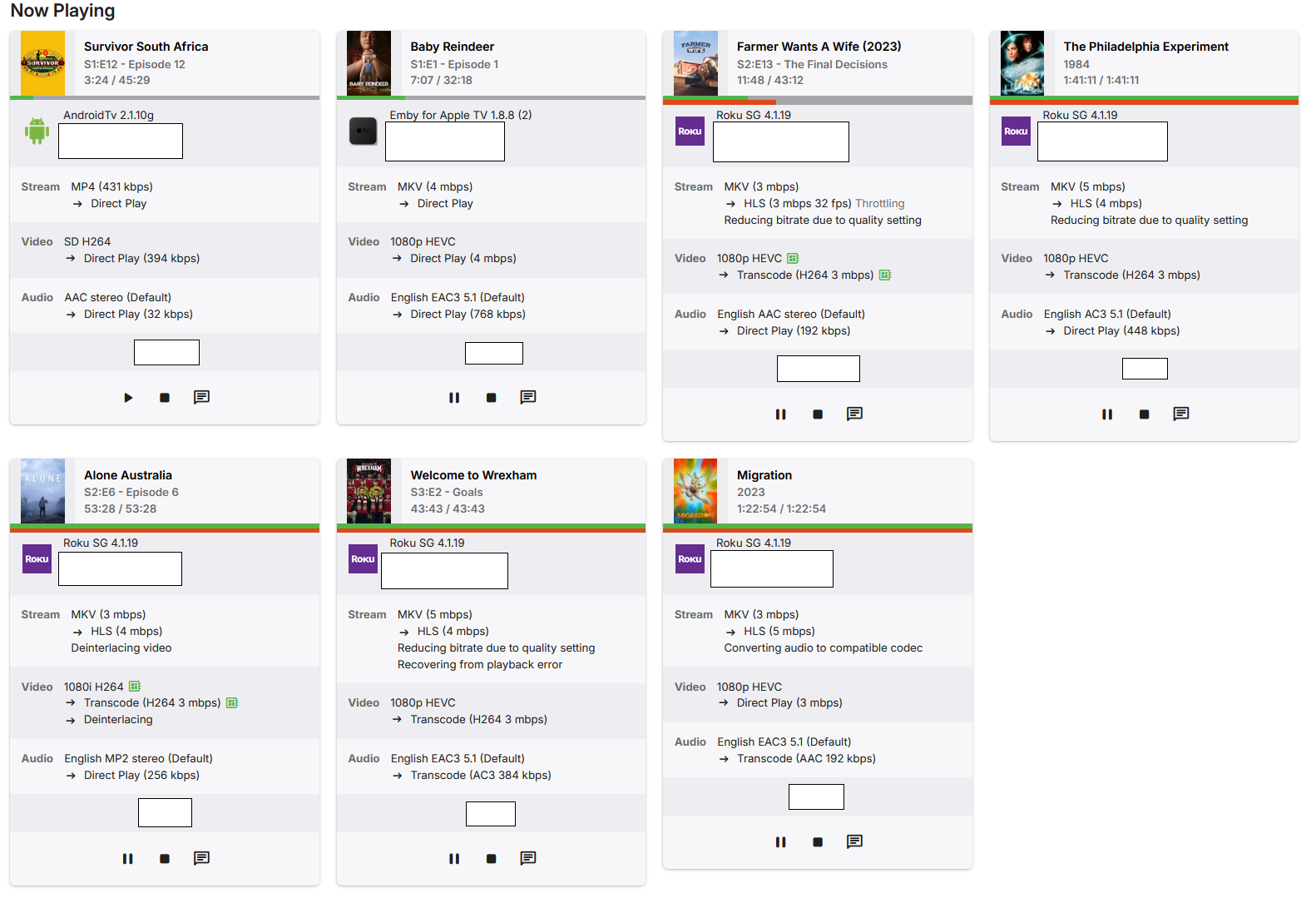

cwills75 14 Posted March 25, 2024 Posted March 25, 2024 I've been having issues with the server after the last few updates. I'll get clients with stuck streams, and often the streams will bounce between what is showing and something else entirely different. Pressing pause/stop doesn't do anything, the only way to remove these from the dashboard is to restart the Emby server. Is this a known issue, is there a fix?
speechles 2060 Posted March 25, 2024 Posted March 25, 2024 Apologies. This is a known issue with the Roku presently. We have a solution and it is currently in the testing phase. We should have something very soon to fix this in the Roku app. 1

cwills75 14 Posted May 13, 2024 Author Posted May 13, 2024 On 3/25/2024 at 11:59 AM, speechles said: Apologies. This is a known issue with the Roku presently. We have a solution and it is currently in the testing phase. We should have something very soon to fix this in the Roku app. Is the May 9th 4.1.19 update supposed to fix this issue? I'm still seeing stuck stream with Roku devices and hitting stop does nothing to remove them. I have to reboot the docker to clear the streams, but they just come back as Roku clients watch things.
speechles 2060 Posted May 13, 2024 Posted May 13, 2024 @cwills75 The 2nd part of my post above mentions this problem with hanging playback at the end. Rather than wait for a cure we will just change the code in the Roku to act defensively and solve this once and for all. There are two long-standing problems in the Roku app that we must fix ASAP. Please give us a bit of time and these problems will be solved very shortly. Thanks again for keeping us aware this is a still a problem. We will have something soon. 3

ebr 16306 Posted August 13, 2024 Posted August 13, 2024 On 8/10/2024 at 12:24 PM, Erik said: Hi @speechlesjust checking to see if this is corrected in the App currently or not before I was going to report that it is still happening, but not as often it seems. I do have 1 or 2 streams stuck every couple days or so (where before it was many more every day). Thanks! The issue reported here (the display on the dashboard when the client is actually gone) and the one mentioned by Speechles (where playback actually stalls at the end on the client) are two different issues. The latter one should be tested with the latest beta of the server.
cwills75 14 Posted August 13, 2024 Author Posted August 13, 2024 2 minutes ago, ebr said: The issue reported here (the display on the dashboard when the client is actually gone) and the one mentioned by Speechles (where playback actually stalls at the end on the client) are two different issues. The latter one should be tested with the latest beta of the server. Has the former issue within the Roku app itself been fixed? Unfortunately as much as hate Roku devices for this and other reasons, nobody ever listens to me, lol.
ebr 16306 Posted August 13, 2024 Posted August 13, 2024 12 minutes ago, cwills75 said: Has the former issue within the Roku app itself been fixed? The first issue (the items staying on the server dashboard when the client is gone) is not a problem in the Roku app. 18 minutes ago, ebr said: The latter one should be tested with the latest beta of the server.

JohnMason1 2 Posted October 8, 2024 Posted October 8, 2024 I'm sure everyone's aware, but just chiming in to say I have just noticed the stuck-stream issue myself on my Roku (after about 2 weeks of watching where it didn't happen). Is the only way to clear it to restart the Emby service? I don't think I've seen this suggestion elsewhere, but wouldn't it help to have a 'stop stream' button like Plex has? 1
JohnMason1 2 Posted October 9, 2024 Posted October 9, 2024 Sorry to chime in again, but I am just noticing that Android TV (Shield) is also producing stuck streams on the server. So I currently have one stream stuck from a Roku client and one from Android TV. Is there anything I can do about these other than restart the server/service?
Carlo 4561 Posted October 9, 2024 Posted October 9, 2024 16 hours ago, JohnMason1 said: Sorry to chime in again, but I am just noticing that Android TV (Shield) is also producing stuck streams on the server. So I currently have one stream stuck from a Roku client and one from Android TV. Is there anything I can do about these other than restart the server/service? Hi, Have you tried rebooting the device itself?
pwhodges 2023 Posted October 9, 2024 Posted October 9, 2024 16 hours ago, JohnMason1 said: Is there anything I can do about these other than restart the server/service? No. But it may help reduce them happening if you always take care to close down a stream from the client by using the back button, rather than jumping out of the client (the home button on the Roku is especially bad for that). Paul
JohnMason1 2 Posted October 14, 2024 Posted October 14, 2024 On 09/10/2024 at 17:07, Carlo said: rebooting the device itself? Hiya, do you mean reboot the Roku and/or the Shield themselves? No I have not, it's not something I routinely do. I will try it, but it's not a sustainable solution for the long term to reboot the client every time we stop watching. On 09/10/2024 at 17:56, pwhodges said: using the back button, rather than jumping out of the client Hmm I always either let the stream end (and back to Emby, I don't have it set to autoplay next episode), or I use the back button exclusively, I never exit with the home button from a stream; I only use the home button if I am on Emby's menu screens. I have currently set my Emby server to restart the Emby service every day at 6am, at least that gets rid of the stuck streams for now and no one's watching at that time.
Happy2Play 9798 Posted October 14, 2024 Posted October 14, 2024 On 10/8/2024 at 5:03 PM, JohnMason1 said: Is there anything I can do about these other than restart the server/service? 3 minutes ago, JohnMason1 said: I have currently set my Emby server to restart the Emby service every day at 6am, at least that gets rid of the stuck streams for now and no one's watching at that time. Yes that is currently the only option to clear stuck/abandoned sessions on the Dashboard.
