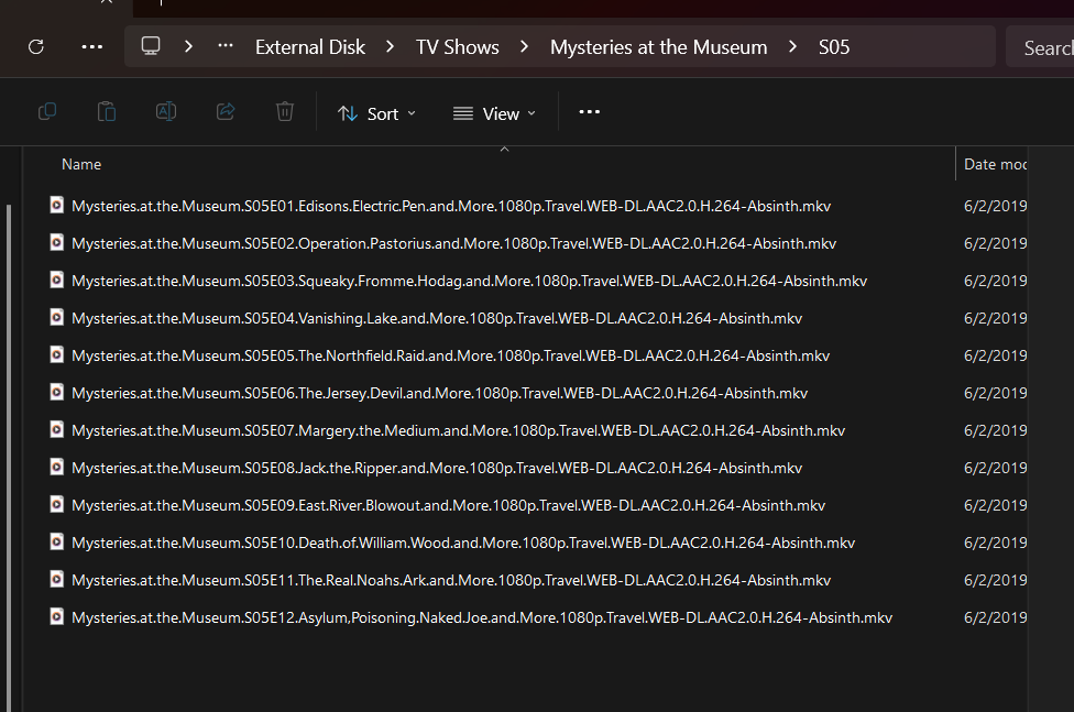

dvesely 3 Posted March 20, 2024 Posted March 20, 2024 Hello Emby People! I am trying to get subtitles for TV episodes. In particular I have all seasons of Mysteries at the Museum. I have setup my folder and file structure like the example on this page with the exception that my episodes also contain the name of the episode. I have configured opensubtitles.COM but it never finds subtitles for these episodes. (I set the library to auto download and have tried manually downloading them using Emby) Some episodes say they have subtitles called (Default EIA_608) but these won't load. I'd really appreciate help fixing this. Attached is a sample of my file structure as a picture is worth... Dan

pwhodges 2039 Posted March 22, 2024 Posted March 22, 2024 Try adding .en before .srt in each file name (like "<name>.en.srt"), so that Emby can see that they are English subtitles. And what subtitle mode do you have in your app settings, anyway? Paul

visproduction 338 Posted March 25, 2024 Posted March 25, 2024 On 3/23/2024 at 12:14 PM, dvesely said: Adding .en did not help. Where do I check the subtitle mode? What should it be set for? DV, Adding .en makes the subtitle recognized as English. Adding .default will turn it on automatically when you play the media. Add the file in the same folder as the media: Tatort S12E04 - 720P.mp4 Tatort S12E04 - 720P.en.default.srt English subs will automatically appear when this episode is played. if you only make the file name: Tatort S12E04 - 720P.en.srt Then the subtitles will appear, only when the subtitle option is selected and the English subtitles is clicked. The subtitles will not play automatically unless there is a .default added to the file name. Hope that helps. 1

rbjtech 5345 Posted March 26, 2024 Posted March 26, 2024 So only the 1st one has a non .en.srt file - does this show 2 subtitles listed or only one ? I note they are different file sizes. As these are self generated .srt files - maybe worth posting one on here - it should be a plain text file in the format # time start --> time finish subtitle As above - your log only shows detection of s01e01 - so it is picking up the non .en subtitle most likely. You can test by adding text to a subtitle. What do you have set in your TV Library for subtitles ?
dvesely 3 Posted March 26, 2024 Author Posted March 26, 2024 The subtitle file for E01 was downloaded by Emby. It works and appears in Emby. All the others were created by Subtitle Edit and they do NOT appear in Emby. The subtitles play with the video perfectly outside of Emby.
