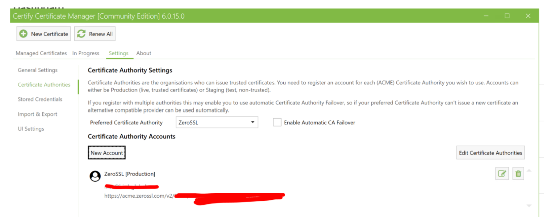

djerniehoule 23 Posted March 20, 2024 Author Posted March 20, 2024 I have installed CTW, I don't see where to do this... 5b - tell CTW about Zerosll under CTW...settings....set the preferred certificate authority and add new account..this is what mine looks like.
ginjaninja 605 Posted March 20, 2024 Posted March 20, 2024 (edited) 12 hours ago, djerniehoule said: I have installed CTW, I don't see where to do this... 5b - tell CTW about Zerosll under CTW...settings....set the preferred certificate authority and add new account..this is what mine looks like. edit ive updated the instructions previously for clarity. Edited March 21, 2024 by ginjaninja

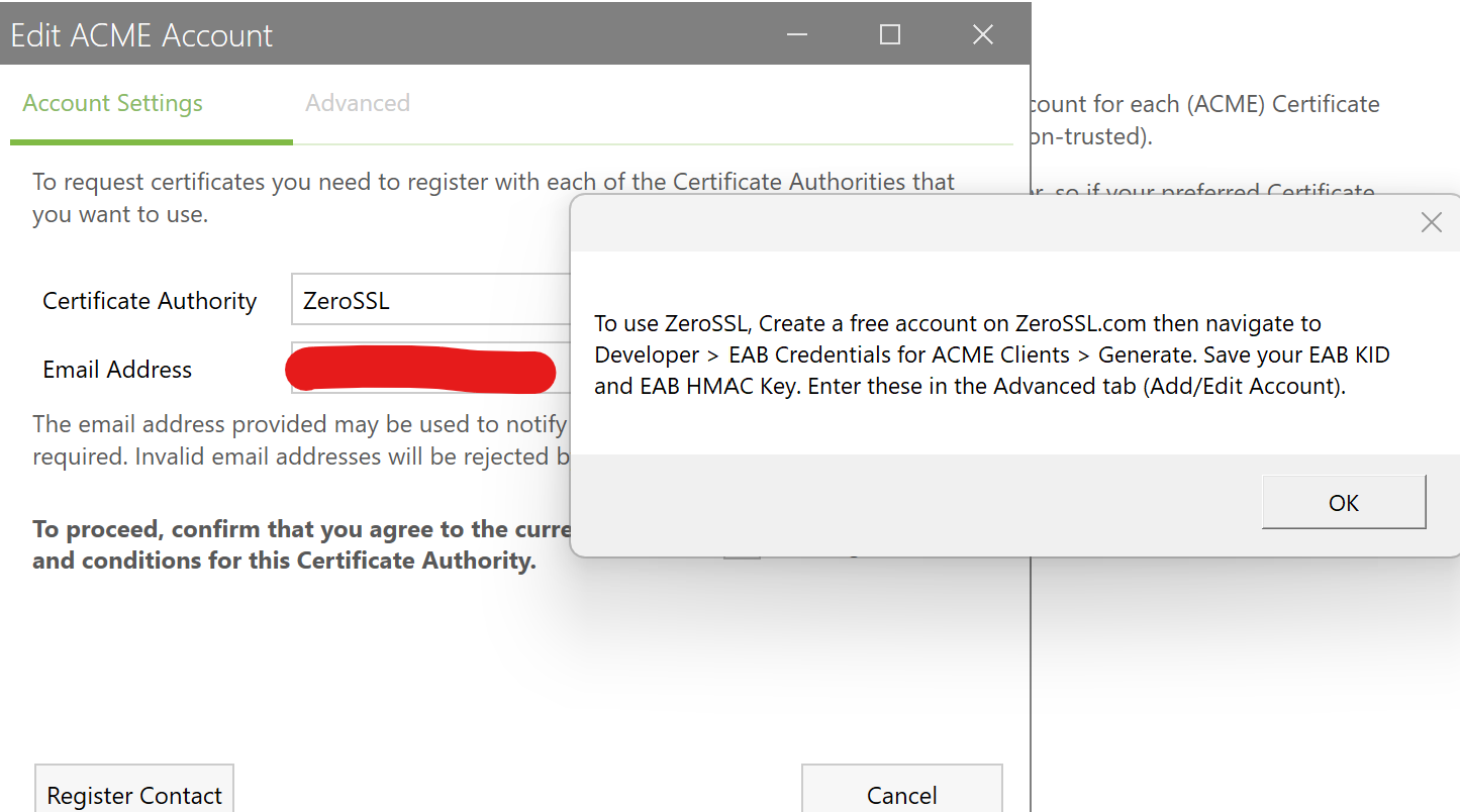

ginjaninja 605 Posted March 20, 2024 Posted March 20, 2024 Ok its say what to do.. when you click register contact Go to zero ssl, login to your account, go to developer and click gnerate - this will generate a keyid and key (hmac) which you enter on advanced tab on the new account in CTW. im not going to click generate myself as it will probably change my config, but hopefully when you click it...the result will be obvious.. you can enter the information and click register in ctw...
djerniehoule 23 Posted March 20, 2024 Author Posted March 20, 2024 Right now under "certificate authority settings" I see Zerossl (production)
ginjaninja 605 Posted March 20, 2024 Posted March 20, 2024 (edited) Good stuff, hopefully thats worked... so continue with the rest of the CTW setup..click request certificate and see if it creates the pfx.. (i would wait 2 mins after clicking request and before retrieving the log) otherwise pm me the log file and copy and paste the preview summary of setup if you can NB i dont think test works for me so dont be discouraged if test doesnt work.... Edited March 20, 2024 by ginjaninja
