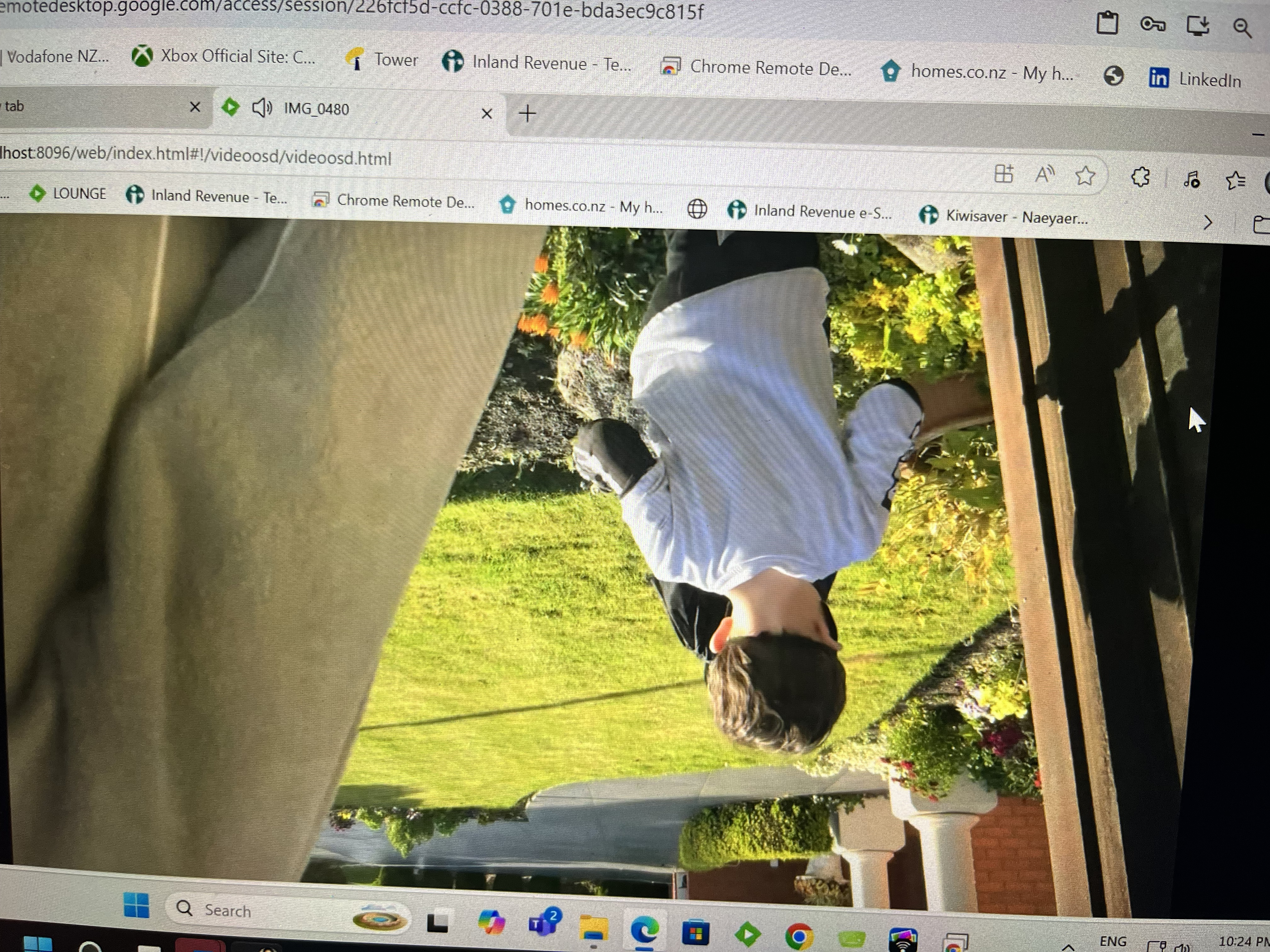

Robnaeyaert 22 Posted May 14, 2024 Author Posted May 14, 2024 On 5/11/2024 at 6:46 PM, Robnaeyaert said: Hello. My server is 4.8.6 and I refreshed my metadata and the problem still exists. again the thumbnail is correct and it plays correctly in VLC but is upside down in Emby. Any ideas - this is annoying. thanks. Hello?????? can anyone help? not getting any replies thank you

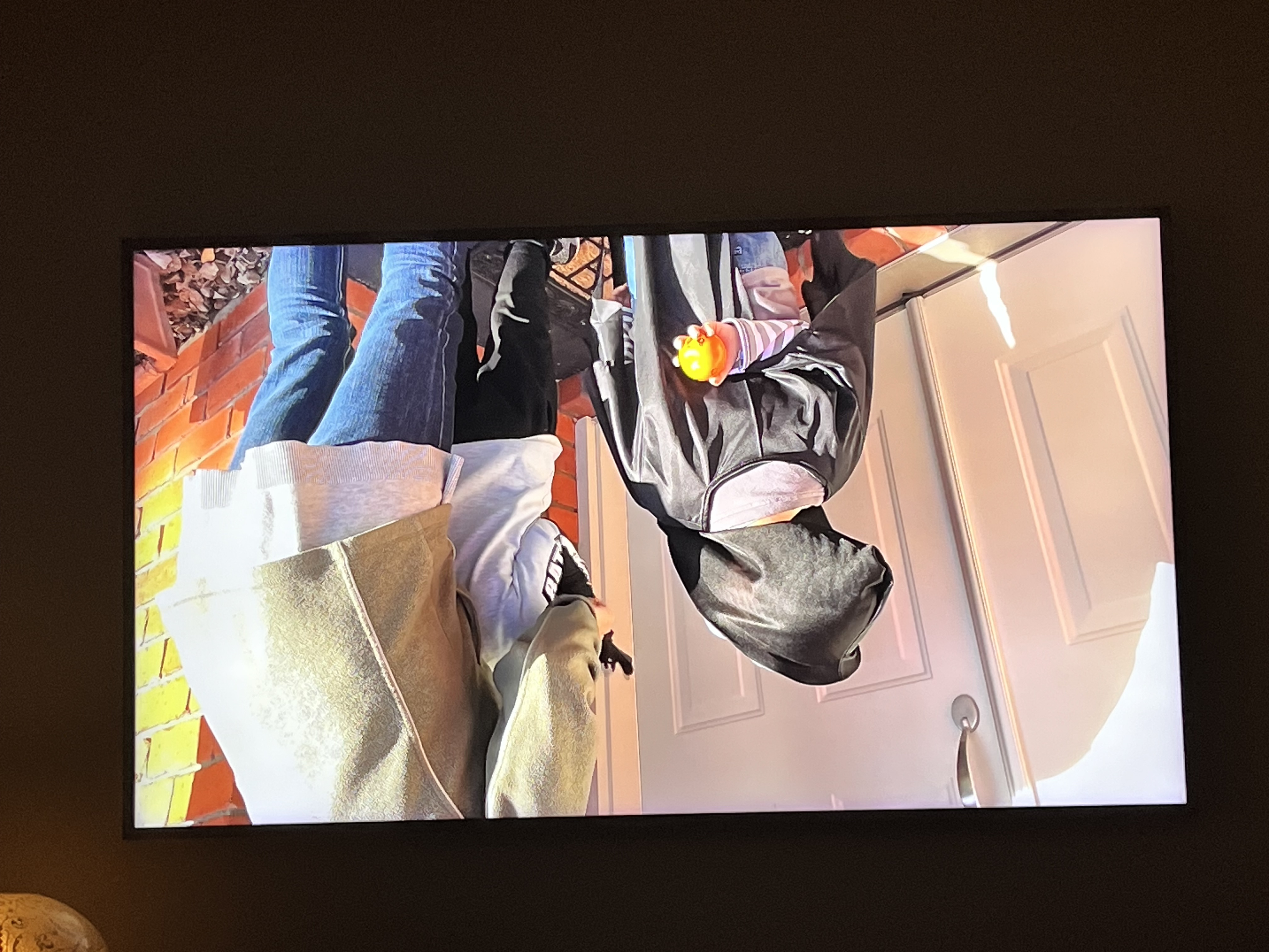

SamES 1084 Posted June 13, 2024 Posted June 13, 2024 1 minute ago, Robnaeyaert said: I’m using the App Store app “Emby air Samsung 1.8.0”. I’ve said this a million times….. video plays perfect in media player on windows 11 server. video plays perfectly on IOS Emby app. video ONLY plays upside down on my Samsung TV Emby app. can’t understand why this is so difficult to get sorted sorry just frustrated at the lack of any support given I paid of premium It's because the Samsung internal player doesn't autorotate the video on some models and there is no player function to support rotating the video. We have a fix that involves rotating it on the server before playback, and that is in the USB version released this week. There is still an issue with the video being cropped when it is rotated, but that will need a server fix to resolve it which I hope will come soon.
SamES 1084 Posted June 13, 2024 Posted June 13, 2024 On 14/05/2024 at 22:09, SamES said: Did you see my post above yours? Can you please confirm that there is now a rotation value shown for the media's video stream? Can you please provide me a sample for testing? Part of the reason that this has taken so long is you didn't reply to my request above - now that another user has, I've been able to resolve this. Can you please confirm the first point - 'is there a rotation value shown for the medias video stream on the server' as this is also critical?
Robnaeyaert 22 Posted June 14, 2024 Author Posted June 14, 2024 23 hours ago, SamES said: It's because the Samsung internal player doesn't autorotate the video on some models and there is no player function to support rotating the video. We have a fix that involves rotating it on the server before playback, and that is in the USB version released this week. There is still an issue with the video being cropped when it is rotated, but that will need a server fix to resolve it which I hope will come soon. Thank you so much for the update. can you please advise what version of the server will have this fix so I can watch out for it?

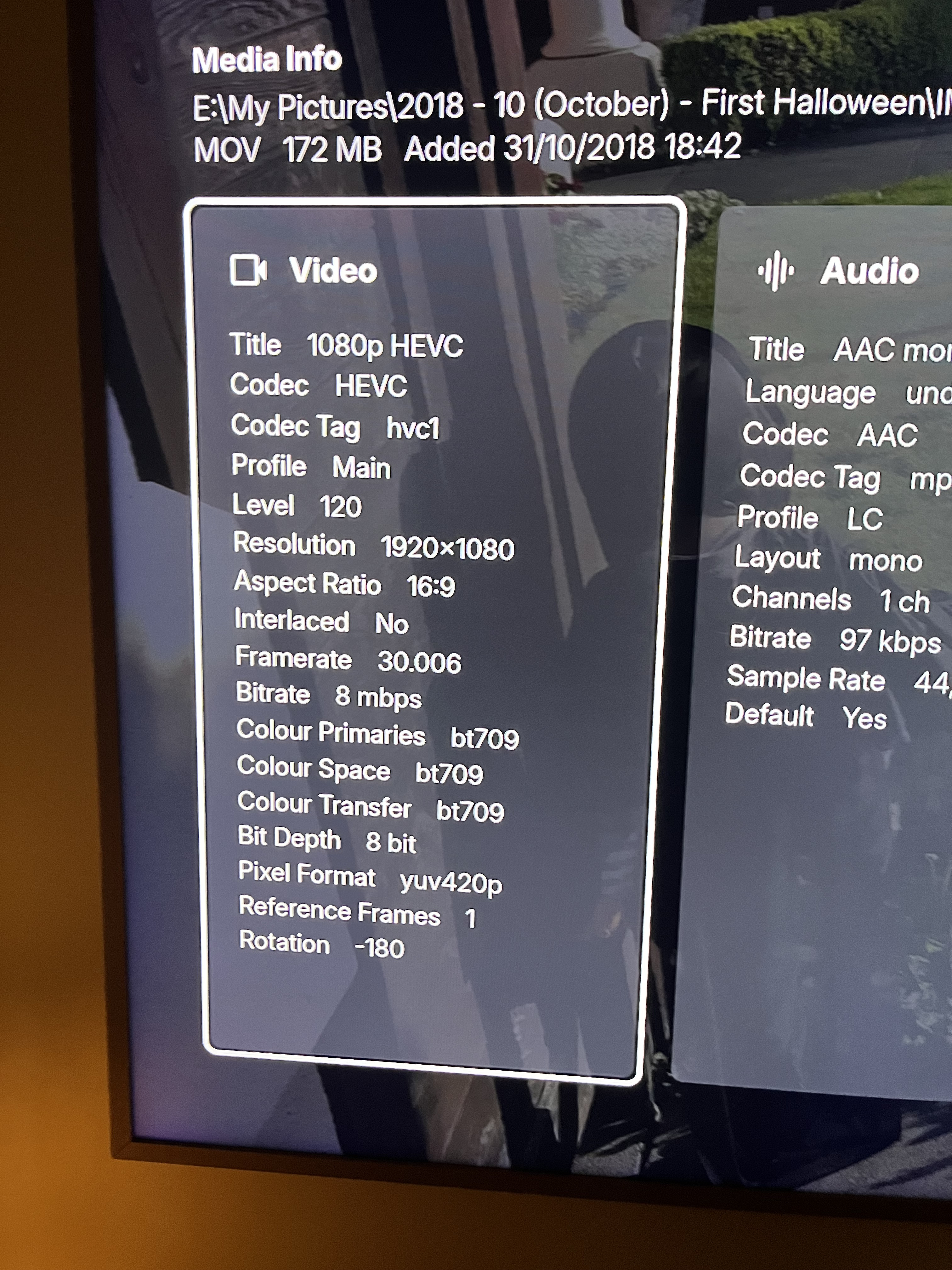

Robnaeyaert 22 Posted March 13, 2025 Author Posted March 13, 2025 On 10/1/2024 at 1:34 AM, SamES said: But have you provided this information that we asked for? As Luke advised, please check the same way that you did here: We need to confirm that after the update there are now the correct rotation values. @Luke@SamESThis issue is still ongoing on my Emby system. I have no idea what you are talking about regarding "Correct Rotation Values" - I see no settings at all on "rotation". I do see "Lock", "Playback Speed" etc etc but I can not for the life of me see any setting for rotation. Take a look at the latest upload of my home video on my iPhone where the Thumbnail is the correct way up but the video plays upside down. I'm beyond frustrated as I'm sure there is a simple fix for this. This example below is a video captured on my iPhone 13 loaded on my EMBY server just weeks ago and then streaming that on my Emby IOS 2.2.35 app and it plays the wrong way up (THIS EXAMPLE HAS NOTHING TO DO WITH MY EARLIER SAMSUNG TV EXAMPLE OF THE SAME PROBLEM). Can *ANYONE* please help as I'm tearing my hair out. Am I recording the wrong way up on my iPhone (as I assumed it doesn't matter) or is there a setting I'm missing? ARHG! Many thanks

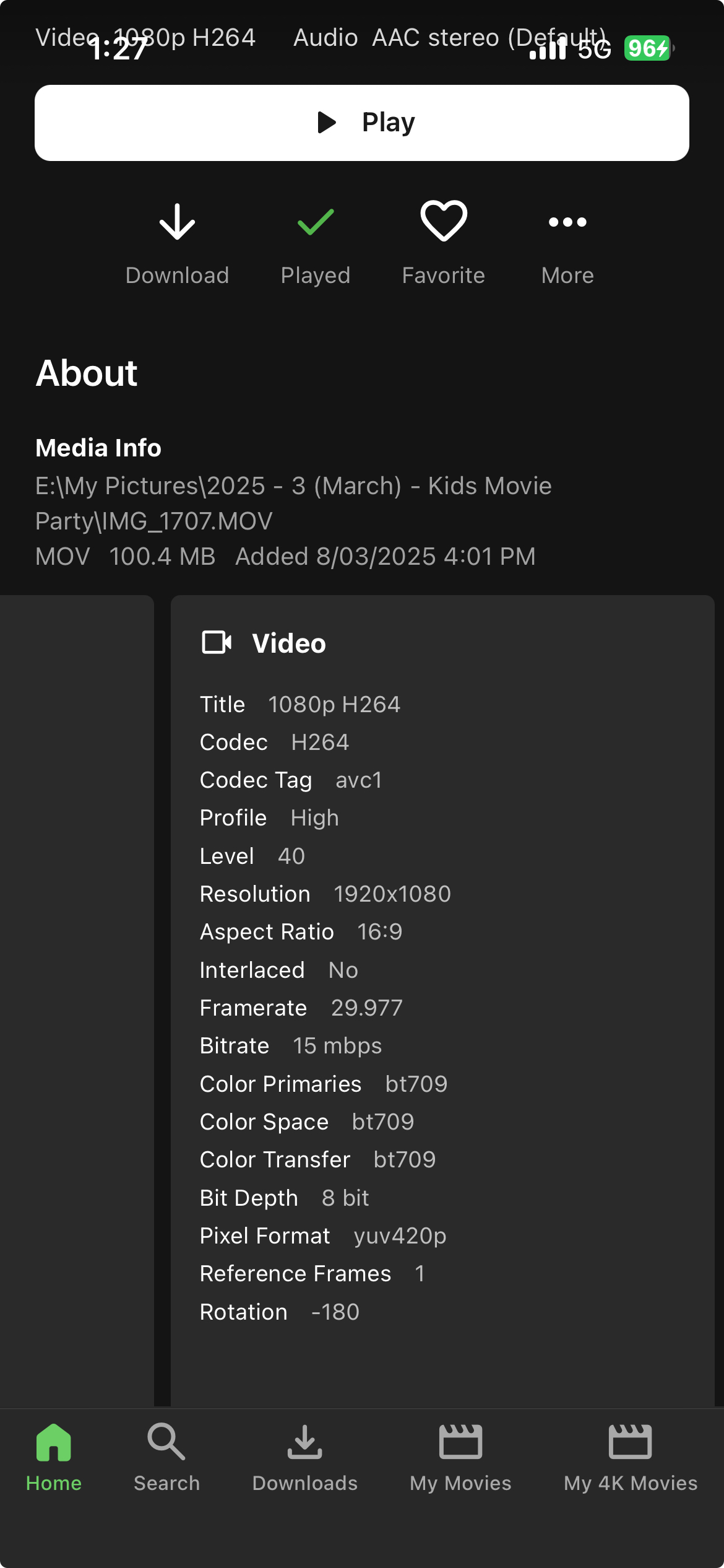

SamES 1084 Posted March 13, 2025 Posted March 13, 2025 In your screenshot, can you please show us all the information in the panel called 'Video' that is just visible in the bottom right corner. This is the video media info that we've previously asked about. Thanks

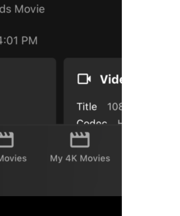

Robnaeyaert 22 Posted March 14, 2025 Author Posted March 14, 2025 (edited) 4 hours ago, SamES said: In your screenshot, can you please show us all the information in the panel called 'Video' that is just visible in the bottom right corner. This is the video media info that we've previously asked about. Thanks Thanks @SamESplease find attached image (sorry I didnt know what you meant) Yes I see the rotation "-180". I dont know where to edit that? Is there somewhere I can edit it to make it "0" please? Edited March 14, 2025 by Robnaeyaert
SamES 1084 Posted March 14, 2025 Posted March 14, 2025 (edited) Perfect, thanks. The ‘Rotation -180’ is the important part. That means the server knows it needs to be rotated, but we do still have some issues with correctly rotating some movies so I expect it will be fixed when that is resolved. Edited March 14, 2025 by SamES
