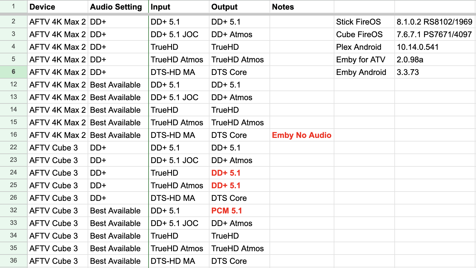

signde 26 Posted May 12, 2024 Posted May 12, 2024 It has been almost 8 weeks and I still cannot play DTS audio in the official Emby for Android TV app on the 4K fire stick. I am guessing the ATV app is abandonware are this point as the latest release is 2.1.10 yet the fireOS store still has 2.0.98a as latest. I also recently picked up a 3rd gen Cube. I was surprised to see it actually does play DTS-HD MA as DTS Core however there are some funny differences between playback of the two devices depending on the fireOS audio options. Here are my findings across both Plex and Emby: From what I can see, the latest stick in these apps will passthrough all these formats no matter which of these two audio settings you use. The cube however, there is no magic setting that will passthrough all of these formats in either app. If you choose DD+, TrueHD will get converted to DD+. If you choose Best Available, non Atmos DD+ gets converted to PCM. You can also see that I tried the latest non ATV, regular Android Emby app with the stick and yet still, no DTS audio. I'm unable to test any other versions of Emby for ATV because while I have unlocked the ATV app through the Amazon store, you can't install a beta over it. Side loading the app gives me a version of the app that isn't unlocked, and won't let me play anything.
Luke 42243 Posted May 13, 2024 Posted May 13, 2024 7 hours ago, signde said: It has been almost 8 weeks and I still cannot play DTS audio in the official Emby for Android TV app on the 4K fire stick. I am guessing the ATV app is abandonware are this point as the latest release is 2.1.10 yet the fireOS store still has 2.0.98a as latest. I also recently picked up a 3rd gen Cube. I was surprised to see it actually does play DTS-HD MA as DTS Core however there are some funny differences between playback of the two devices depending on the fireOS audio options. Here are my findings across both Plex and Emby: From what I can see, the latest stick in these apps will passthrough all these formats no matter which of these two audio settings you use. The cube however, there is no magic setting that will passthrough all of these formats in either app. If you choose DD+, TrueHD will get converted to DD+. If you choose Best Available, non Atmos DD+ gets converted to PCM. You can also see that I tried the latest non ATV, regular Android Emby app with the stick and yet still, no DTS audio. I'm unable to test any other versions of Emby for ATV because while I have unlocked the ATV app through the Amazon store, you can't install a beta over it. Side loading the app gives me a version of the app that isn't unlocked, and won't let me play anything. Hi, using our standard Android app, can you temporarily enable app logging and provide a log from the app? Thanks. 1
signde 26 Posted May 14, 2024 Posted May 14, 2024 (edited) On 5/12/2024 at 10:06 PM, Luke said: Hi, using our standard Android app, can you temporarily enable app logging and provide a log from the app? Thanks. I wish I could. Emby for Android 3.3.83 Go to settings > Logs > settings, enable logging. Exit app from the exit menu in Emby. Restart the app, browse around, play some files, go back to Logs - It shows 0 log files.I have tried this several times, restarting the app several times. This is on the AFTV Stick 4K Max 2. The above steps work fine on the Cube, but DTS is playing there. Edit: FireOS 8 also locks down the app directories, you cannot access "/Android/data/<app bundle id/" on FOS8 devices externally, so I can't check the logs directory over ADB or something like Total Commander either. Edited May 14, 2024 by signde
Luke 42243 Posted May 14, 2024 Posted May 14, 2024 5 hours ago, signde said: I wish I could. Emby for Android 3.3.83 Go to settings > Logs > settings, enable logging. Exit app from the exit menu in Emby. Restart the app, browse around, play some files, go back to Logs - It shows 0 log files.I have tried this several times, restarting the app several times. This is on the AFTV Stick 4K Max 2. The above steps work fine on the Cube, but DTS is playing there. Edit: FireOS 8 also locks down the app directories, you cannot access "/Android/data/<app bundle id/" on FOS8 devices externally, so I can't check the logs directory over ADB or something like Total Commander either. Hi, you need to fully close the app after changing the option, meaning force close. Just coming out and back in might not do that. Please give it another shot. Thanks.
signde 26 Posted May 14, 2024 Posted May 14, 2024 10 minutes ago, Luke said: Hi, you need to fully close the app after changing the option, meaning force close. Just coming out and back in might not do that. Please give it another shot. Thanks. I used the exit feature built in to the Emby menu - I guess that is not good enough. Force stop did the job it looks like. Here is the log file of trying to play 3 different DTS-HD files on that device, all of which produced no audio. https://pastebin.com/thpkmbmK
