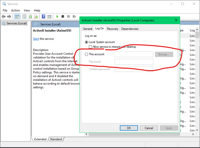

Neminem 1593 Posted March 16, 2024 Posted March 16, 2024 Can you check the service. And confirm that the service it using the user that can access media files.
brucmao 0 Posted March 16, 2024 Author Posted March 16, 2024 26 minutes ago, jaycedk said: Can you check the service. And confirm that the service it using the user that can access media files. This user is the user I am currently logged into the system with. I also think it may be a permissions or user credentials issue. I have tried using a high-privilege user like Administrator but still cannot see these mounted drives. I asked chatgpt, and it suggested using UNC paths instead of mounting as local drives.
