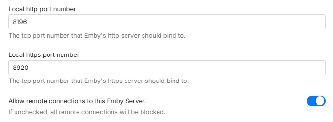

Sorry for the huge delay, I lost access to my account for a while. Currently, my certificate appears fully functional. For posterity, my setup is detailed below.
----- Certificate renewal and conversion
I use Letsencrypt and a DDNS service. To update the Emby certificate with LE, I have a script in "/etc/letsencrypt/renewal-hooks/deploy/deployhook.sh". After converting the cert, I "chown & chmod" for the "user:group" that the Emby service runs under (I use systemd to run "emby-server.service").
#!/bin/bash
logpath=/var/log/certbot-renew.log
echo "$(date) renewing certs DEPLOY-HOOK" >> $logpath
# location of active/latest LE certificates
le_dir="/etc/letsencrypt/live"
# your dns name associated with your WAN/external IP address
dns_name="YOURDOMAIN"
# where to put your .pfx cert
emby_dir="YOURembyFOLDER"
### stop running emby server
echo "$(date) stopping emby-server" >> $logpath
systemctl stop emby-server >> $logpath
### handle Emby cert
# backup existing
echo "$(date) mkdir -p $emby_dir/bak" >> $logpath
# put in your emby-server "user:group"
chown -R user:group $emby_dir/bak
echo "$(date) mv emby/*.pfx $emby_dir/bak/" >> $logpath
mv $emby_dir/*.pfx $emby_dir/bak/
# convert certificate to Emby compatible format.
# replace "certpass" with password that you will put into the Emby network configuration
echo "$(date) openssl convert to pkcs12" >> $logpath
openssl pkcs12 -export -out $emby_dir/$dns_name.pfx -inkey $le_dir/$dns_name/privkey.pem -in $le_dir/$dns_name/cert.pem -certfile $le_dir/$dns_name/chain.pem -passout pass:certpass
echo "$(date) chown user:group" >> $logpath
chown user:group $emby_dir/$dns_name.pfx
chmod u=rwx,g+rwx,o=r $emby_dir/$dns_name.pfx
# restart Emby service
echo "$(date) emby-server restarting" >> $logpath
systemctl restart emby-server >> $logpath

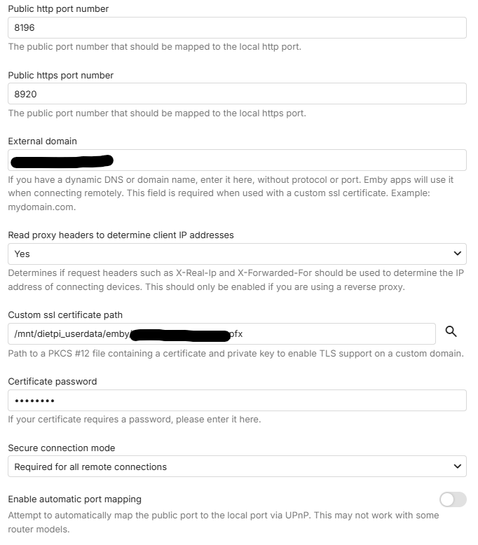

----- Emby settings
....... The public https port is what I use from Emby apps (TV, mobile, etc.). The certificate password is set inside the deployhook script.
!!WARNING!!: this is a potential security risk if not set up appropriately. My unsecured port is not forwarded externally (at the router/modem, etc.).
----- DNS (so that my domain works on local network using "domain.com:port" from Emby apps)
I run Pi-hole for ad-blocking and such. I set a local DNS for my own domain name --> my server LAN ip address. This way, my devices will connect to my Emby instance directly over LAN when on my local network, instead of going out over the internet and back.
I think that's all. Hope this helps someone.
