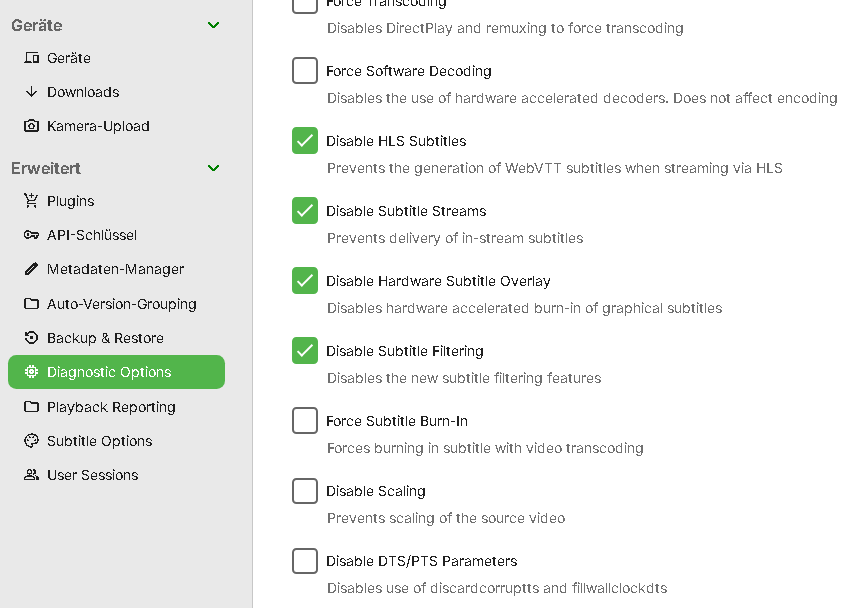

BlackDub 50 Posted May 6, 2024 Posted May 6, 2024 1 hour ago, Leinad86 said: @BlackDub Try activating these two options. You need the Diagnostic plugin for this, you can activate it there. After that everything was working again for me. You have to set these options again after every restart. - Hope it helps you this seems to fix the problem. Is there a way to activate it every reboot? Does activating this option have any negative impact? Thanks 1
Leinad86 6 Posted May 6, 2024 Author Posted May 6, 2024 Glad to hear. I haven't found anything negative so far. Unfortunately, I don't know how it can be activated permanently! I was happy that I found the solution and am just waiting for a solution from the Dev Team. 1
Arthessia 12 Posted May 22, 2024 Posted May 22, 2024 hi, sorry to coming back on this, where did you see those parameters? On 5/6/2024 at 9:09 AM, Leinad86 said: @BlackDub Try activating these two options. You need the Diagnostic plugin for this, you can activate it there. After that everything was working again for me. You have to set these options again after every restart. - Hope it helps you
Arthessia 12 Posted May 22, 2024 Posted May 22, 2024 2 minutes ago, Arthessia said: hi, sorry to coming back on this, where did you see those parameters? It's ok I got it, I need the Diagnostic plugin and then Diagnostics options and here they are... I checked both options thanks! 1
Leinad86 6 Posted May 22, 2024 Author Posted May 22, 2024 @Arthessia You have to download the Diagnostic plugin. After installation & restart you will get the Options 1

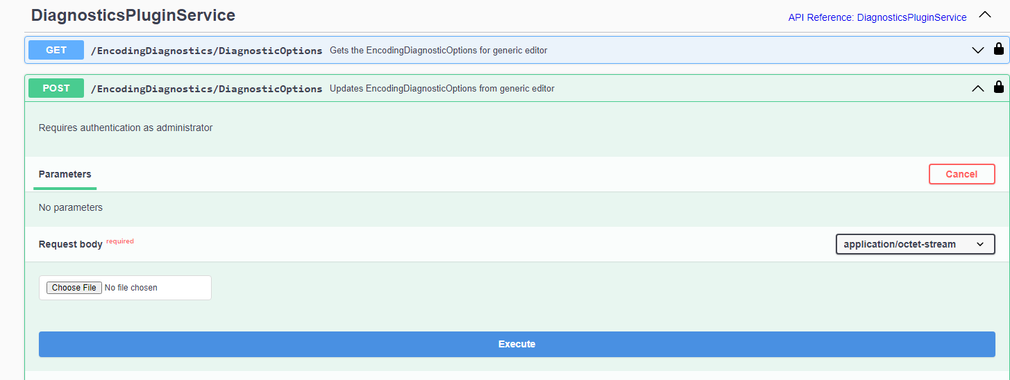

Happy2Play 9798 Posted June 21, 2024 Posted June 21, 2024 On 5/6/2024 at 1:34 AM, BlackDub said: this seems to fix the problem. Is there a way to activate it every reboot? 11 hours ago, ninefast said: Is there no one who can create a Python program that modifies these parameters? This way we can use it as an example. In the meantime, I have created a video macro that modifies the parameters every time Emby restarts. Well the plugin setting are in the API so you could just send the post to reapply them. And run a script every time you restart Emby.
