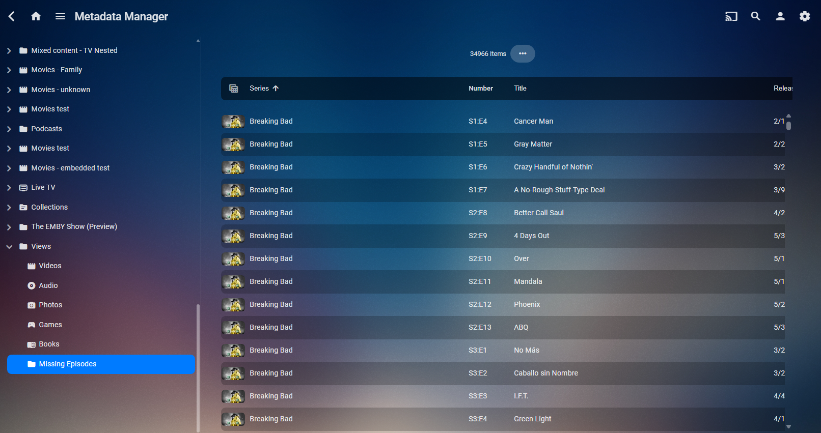

Luke 42288 Posted March 4, 2024 Posted March 4, 2024 The Missing Episodes view in the metadata manager provides the same information that you were getting before from the Reports plugin. Does this answer your question?
kbeck 64 Posted March 4, 2024 Author Posted March 4, 2024 3 minutes ago, Luke said: The Missing Episodes view in the metadata manager provides the same information that you were getting before from the Reports plugin. Does this answer your question? Doesn't come close. 1. Before I could export. Not all I can do with The Meta Manager is Select All and copy and paste into Excel. Except it only copies the 20 or so lines visible. So I need to do 40+ screens and then massage the data because it's all linear and not formatted like before. 2. The fields available before included some not now available. 3. It takes forever. Before it was 1 minute. Now I had to leave for a an hour. 1
Happy2Play 9814 Posted March 4, 2024 Posted March 4, 2024 1 minute ago, kbeck said: 2. The fields available before included some not now available. Did you click the three dot menu to enable other fields? But yes a download feature is need as the UI chunk loading just does not cut it when you have a large list. 1
