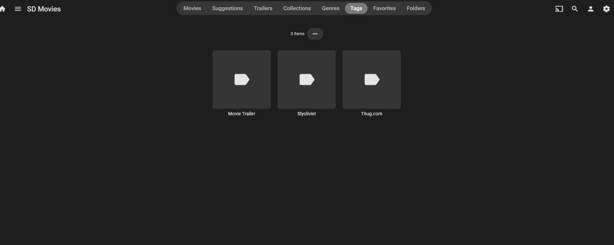

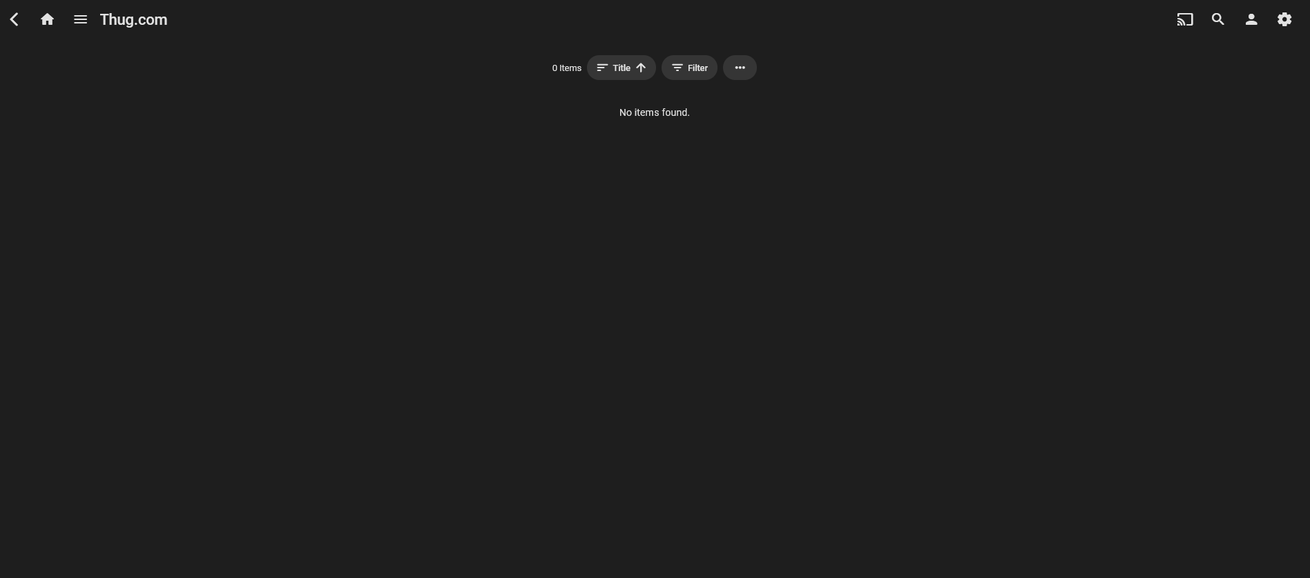

Smitty018210 147 Posted March 4, 2024 Posted March 4, 2024 (edited) Yup I just started to see this today as well. If you click on the icon it goes to blank page and no films are show. I've been trying to figure out were these phantom tags are coming from. One of the ones I have is from thug.com?? What? The only thing I could think of is that emby is some how reading the tags for the themes or trailers that I have locally saved into the movie folders. Edited March 4, 2024 by Smitty018210

Smitty018210 147 Posted March 4, 2024 Posted March 4, 2024 (edited) @Luke I can post a similar image that the first person in the post did, but it will pretty much be the same. Do you need a second image of this? Edited March 4, 2024 by Smitty018210 1

Smitty018210 147 Posted March 4, 2024 Posted March 4, 2024 4 minutes ago, Happy2Play said: From a added tag standpoint I thing we will need an example theme.mp3 for specific media. As for deleted tags would probably need the server logs for when it happened for a specific example. @Happy2PlayThat's not possible when you click on those icons emby takes you to a new screen that is totally blank. I dose not provide any information. I have over 1000 movies. I have no idea what movie those themes/tags are connected too.
