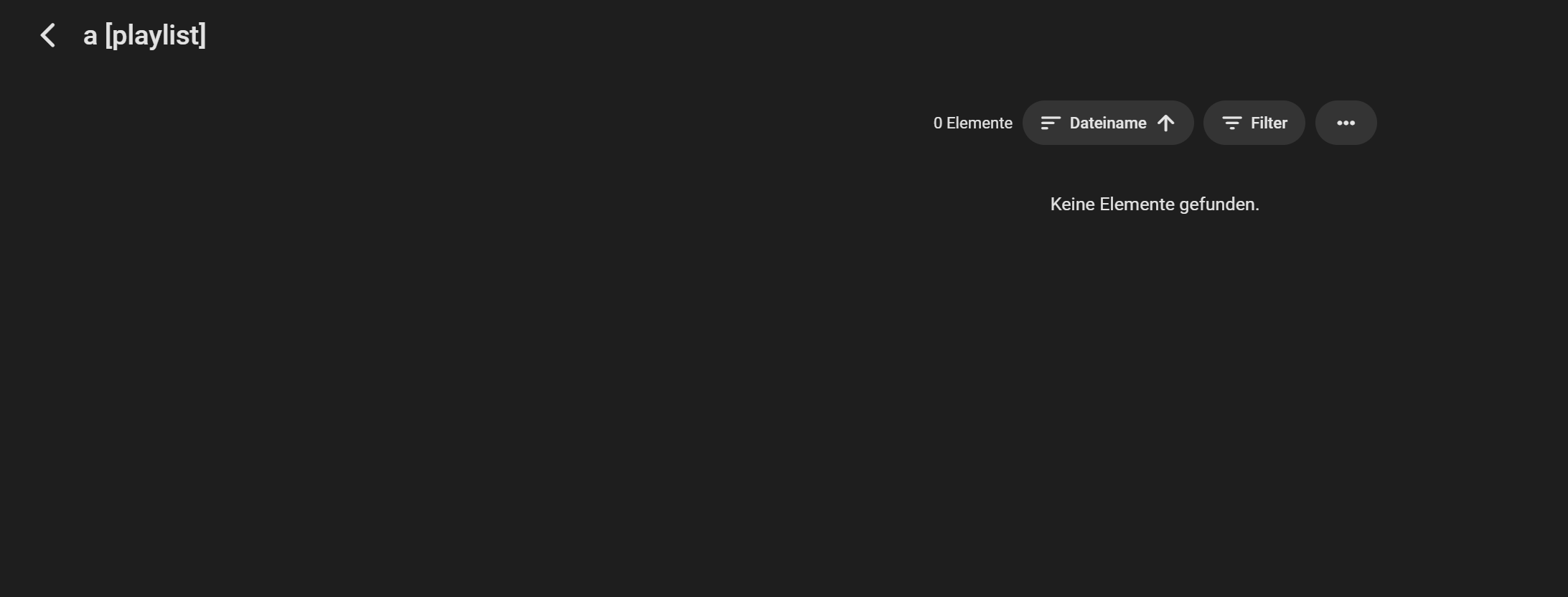

floppy0081 2 Posted March 3, 2024 Posted March 3, 2024 Hallo, I am currently experiencing the issue that the old playlists no longer work. I only see the name of the list but no content. If I delete the lists (XML files) and create new ones, they disappear again after a media scan of the server (Scan media library) Emby Docker 4.8.3.0 I have another test server with 4.8.1.0 - I also have the error here. 1

floppy0081 2 Posted March 3, 2024 Author Posted March 3, 2024 (edited) Her the Log 4.8.1.0 the problem is not only with existing ones. But also with new lists that then disappear. embyserver.txt Edited March 3, 2024 by floppy0081

floppy0081 2 Posted March 3, 2024 Author Posted March 3, 2024 I have already looked at the sharing of the playlists. I have not used a plugin. I can also create a new list. Then also share it with others. But as soon as the media scan is run, everything is gone again...
floppy0081 2 Posted March 3, 2024 Author Posted March 3, 2024 Are the new lists stored in the database or is an XML file still created? No XML file is created when a new list is created.

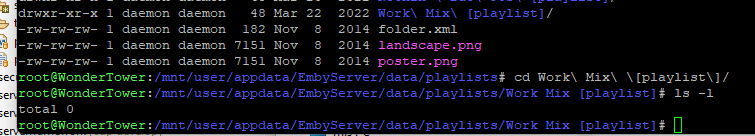

braigo64 7 Posted March 6, 2024 Posted March 6, 2024 (edited) Also having this issue. Went into Emby after the latest update and all playlists are empty. All playlists were created from within Emby and all songs were added to the playlists via Emby menu options. Below you can see the directory for the playlist is empty. I tried creating a new playlist and adding a song to it. The new playlist doesn't show up anywhere. Attached is the log file showing the playlist creation and song added to it. Below is a screenshot showing where the supposed playlist should be located by the directory is empty. embyserver.txt Edited March 6, 2024 by braigo64
floppy0081 2 Posted March 6, 2024 Author Posted March 6, 2024 (edited) That's exactly how it looks for me too. No XML file is created when creating a new one. Directory is empty. I will submit a log if this is not enough from @braigo64. Quote Hi, when you upgrade from 4.7 to 4.8, the server upgrades your xml playlist to m3u8, which is a more standardized playlist format. Where did these xml files come from? just the answer to the question. It is the XML files (playlists) that were created with emby. In the meantime I don't care if the old ones work. It would be nice if I could create new ones Edited March 6, 2024 by floppy0081

floppy0081 2 Posted March 6, 2024 Author Posted March 6, 2024 (edited) okay m3u8... in the folder userplaylists? the folder is empty although I create a list. The list also disappears again after a media scan, as explained at the beginning. Edited March 6, 2024 by floppy0081

braigo64 7 Posted April 4, 2024 Posted April 4, 2024 Emby may think the playlist is created, but the file does not exist. Only the old playlist directories remain in the other directory.

braigo64 7 Posted April 5, 2024 Posted April 5, 2024 I went to an artist, selected add to playlist from the context menu, no playlists were listed in the menu to add to so I clicked on create playlist. I created a new playlist called Work Mix 2. A little toast notification said x number of songs were added to the playlist. Going to the playlist library did not show the newly created playlist. Going to the path on the server showed that there was no m3u file in the directory either.
