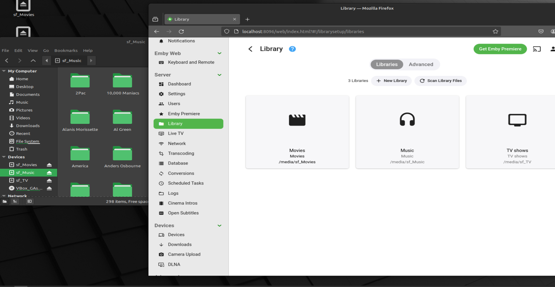

grnerd2021 1 Posted March 2, 2024 Author Posted March 2, 2024 Here is what the permissions on the share in the VM look like. On a whim, I added a user called root, but no change.

grnerd2021 1 Posted March 2, 2024 Author Posted March 2, 2024 Thanks n8tie, but I have no idea what any of that means This is my first foray into the Linux world, and I will do my best to try and figure it out. Are you saying that in Linux, I need to give the Emby server rights to those folders? I don't seem to be able to change the permissions there, see the screenshot above.
