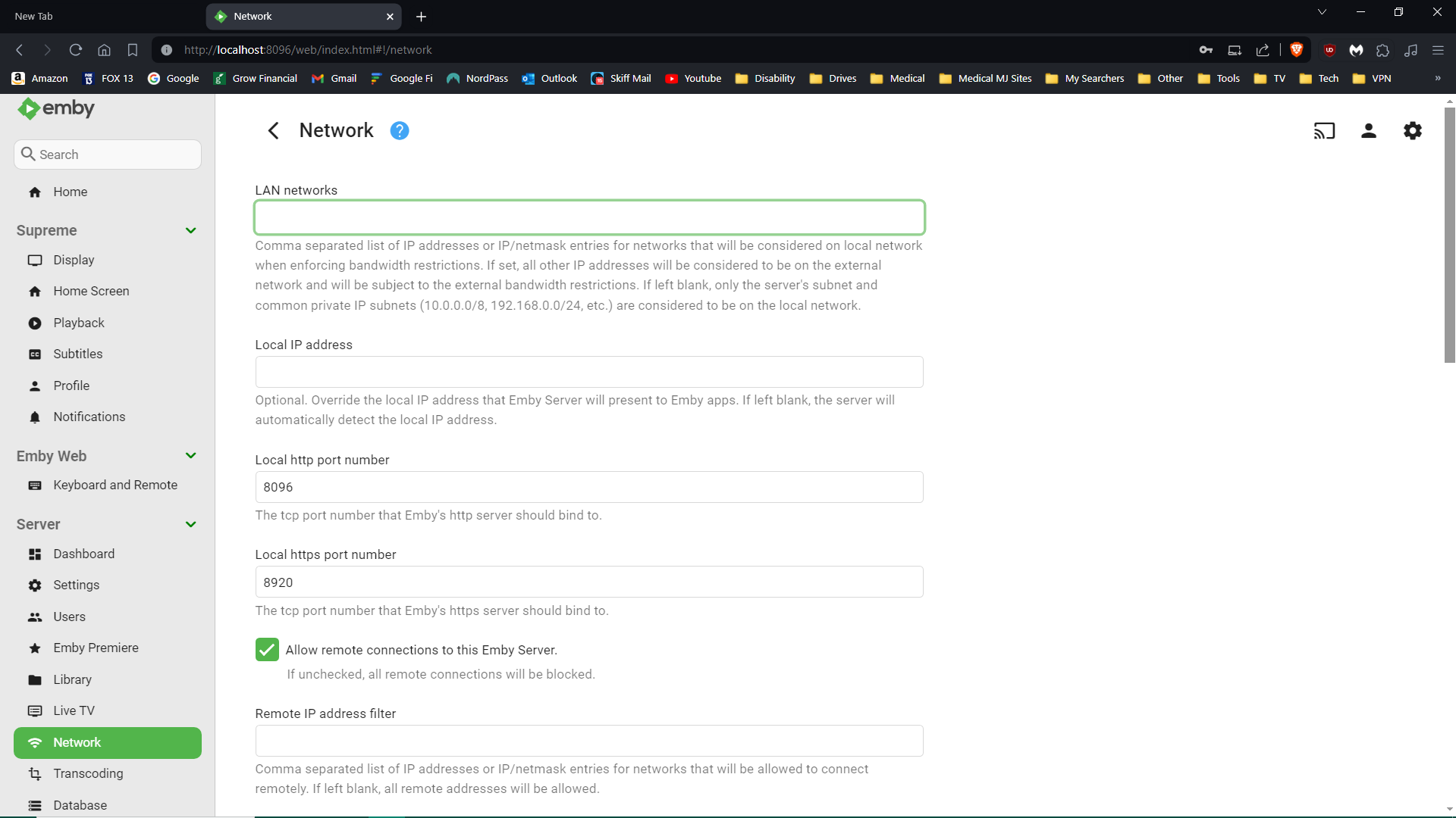

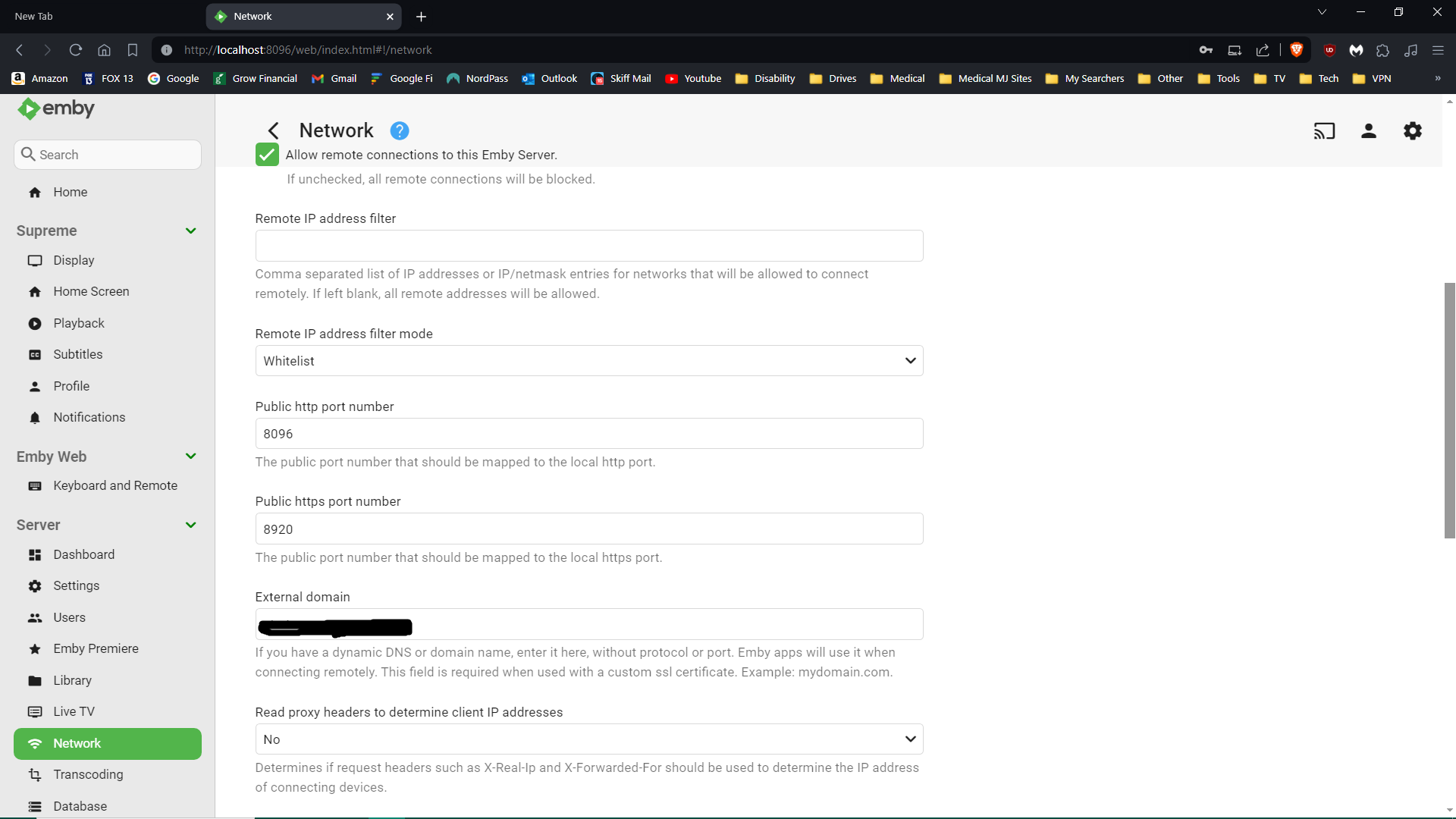

Guest Posted March 1, 2024 Posted March 1, 2024 Can't connect, ddns is setup, I export to folder - extract - website follow process for pfx, router port 8920 to my pc open, in emby locate pfx file enter password, set to required for all connections disabled upnp. Um I can't think of anything else I can possibly screen shot later as I read/seen in ALOT of other posts. I also can't connect through emby connect. Email is setup, password right..
Guest Posted March 1, 2024 Posted March 1, 2024 I can see from dashboard Remote WAN has the https I want and has the correct port 8920 but when I sign in on my phone I can see my server but the message comes up "We're unable to connect to the selected server right now. Please ensure it is running and try again." What is "read proxy headers to determine.." setting? Do I need that put to "only when they contain remote network addresses? Or On or off? Sorry I'm so confused. Brain's turning to mush lol
Luke 42290 Posted March 1, 2024 Posted March 1, 2024 Can you show a screenshot of your emby server network settings? Are you using a reverse proxy?

darkassassin07 674 Posted March 2, 2024 Posted March 2, 2024 (edited) No, 8920 is fine as long as you're fine with entering it when you connect: https://<domain>:8920 Switching to 443 would allow you to enter only https://<domain> into your browser to connect. It's not necessary, just a quality of life thing. Lets get your connection actually working first. As trevor mentioned above: check that your WAN ip (as shown by whatsmyip.com) matches what your domain (ddns) has. Then ensure your router has a port forward rule forwarding 8920 from your WAN ip to the correct LAN ip of your server. Finally try connecting to your domain from an internet connection that's outside your LAN. Mobile data for example. Edited March 2, 2024 by darkassassin07
Lessaj 486 Posted March 2, 2024 Posted March 2, 2024 You should also make sure that https is working internally first, just to make sure since the screenshots you posted of the dashboard were over http. Looks like it's running on your local machine so this URL should work. You'll likely get a certificate error, which is fine, it's just to make sure that the https listener is working properly. https://localhost:8920
