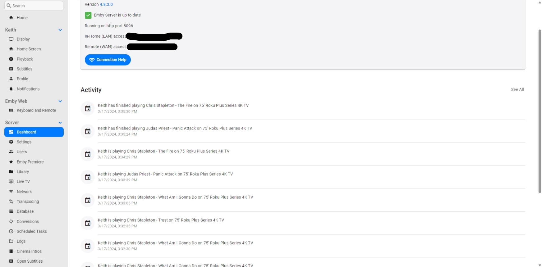

legierk 8 Posted March 17, 2024 Posted March 17, 2024 (edited) Hi guys. My problem is similiar to yours except that I am playing a FLAC audio (only) file. It is on a Roku TV and the app is the latest version. At any rate, the audio is like REEEAAAALLLY slow. Worse than playing a 45rpm record at 33rpm. Weird. As far as I can tell, this is the only file that is doing this. I think other FLAC files are fine....anyhow, just thought I'd throw this out there. This screen shot probably doesn't help, but this is from the server....there is no "error". The file plays, but it's like 1 second is about 5 seconds. (The Judas Priest is mp3 and played fine btw). PS. Thought I'd add that I am now playing the file via my Denon AVR network HEOS (I guess DLNA or something) and it works fine. Edited March 17, 2024 by legierk
Luke 42239 Posted March 21, 2024 Posted March 21, 2024 On 3/17/2024 at 4:54 PM, legierk said: Hi guys. My problem is similiar to yours except that I am playing a FLAC audio (only) file. It is on a Roku TV and the app is the latest version. At any rate, the audio is like REEEAAAALLLY slow. Worse than playing a 45rpm record at 33rpm. Weird. As far as I can tell, this is the only file that is doing this. I think other FLAC files are fine....anyhow, just thought I'd throw this out there. This screen shot probably doesn't help, but this is from the server....there is no "error". The file plays, but it's like 1 second is about 5 seconds. (The Judas Priest is mp3 and played fine btw). PS. Thought I'd add that I am now playing the file via my Denon AVR network HEOS (I guess DLNA or something) and it works fine. HI, if it's only one file, perhaps try re-encoding it?
