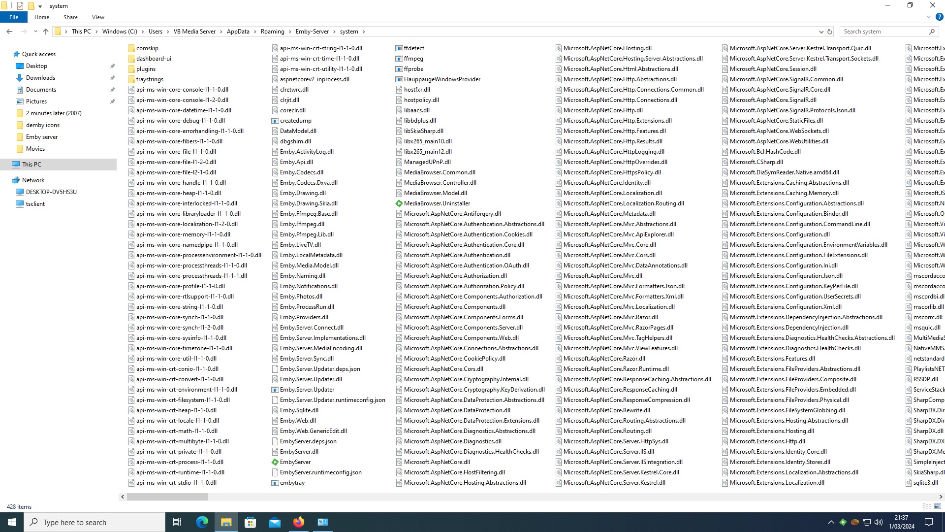

Luke 42288 Posted March 1, 2024 Posted March 1, 2024 7 minutes ago, VBElec said: We have only the standard Windows 10 anti-virus, even switched is off for testing. now running 4.7.11.0 without any problem. If I update to 4.8.3.0, everything seems to be ok, when Emby prompt for restart, and show message that it will take about 2 minutes, after that it is not working anymore. Seems like Emby 4.8.3.0 try to rebuild data base but not succeed. My folder containing program data seems to be read only, but this is now working with 4.7.11.0 With 4.8.3.0 installed, when start Emby server, it comes active for 2 seconds and task manager and shutdown. What are the contents of the system folder?
VBElec 3 Posted March 1, 2024 Author Posted March 1, 2024 Contents, see printscreen, but this is now from 4.7.11.0
Luke 42288 Posted March 1, 2024 Posted March 1, 2024 Can you upgrade to 4.8 again and then show us what it looks like?
VBElec 3 Posted March 2, 2024 Author Posted March 2, 2024 I will Try it later, for the moment get the server back running on 4.7.11.0. I still have print screen from files of data when 4.8 was installed, it look strange.
