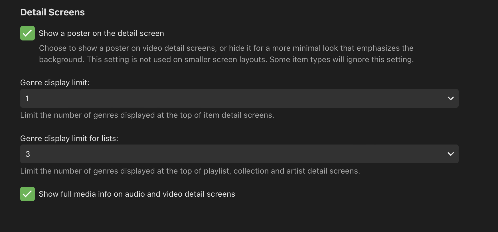

Solution pbzh1 1 Posted February 29, 2024 Author Solution Posted February 29, 2024 Found the problem somehow the setting "Show full media info on audio and video detail screens" was not activated, didn't even now this settings exists, is it new? now the media infos are displayed Thanks you a lot for your fast help!! Pat 1

speechles 2062 Posted February 29, 2024 Posted February 29, 2024 14 minutes ago, pbzh1 said: Found the problem somehow the setting "Show full media info on audio and video detail screens" was not activated, didn't even now this settings exists, is it new? Indeed. I didn't know it existed either. That is something nice to know. Thanks. 1
