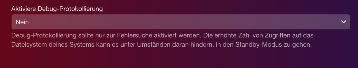

Painkiller88 250 Posted February 28, 2024 Author Posted February 28, 2024 1 minute ago, Luke said: HI, looks like you do have debug logging enabled. ok strange because the server says it is off: Nein = NO
Luke 42184 Posted February 28, 2024 Posted February 28, 2024 Maybe you did at the time of that log file. Anyway the backup process logs just about everything under Debug, so with debug logging disabled, there shouldn't be a whole lot in the log. The Restore process logs just about everything under Info, but that's not something you're going to be running all the time obviously.

Painkiller88 250 Posted February 28, 2024 Author Posted February 28, 2024 10 minutes ago, Happy2Play said: Did you change this setting? But believe debugging requires log rotation or restart to disable debugging. hi, no absolutely not, my server is running and i have set up everything long ago. I haven't changed anything and i never enable the debug log unless someone here asks for it when reporting a problem. I really think there is a problem with the debug log switch or something like that.
Happy2Play 9799 Posted February 28, 2024 Posted February 28, 2024 Devs would know better but will guess the "&" breaks the filter or multiple words. As all others are only one word. But yes reproducible. Debug Backup & Restore:
