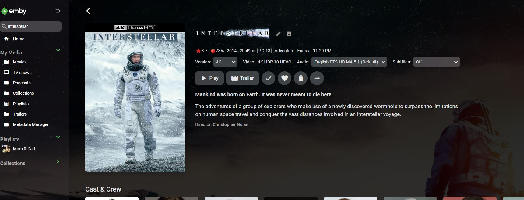

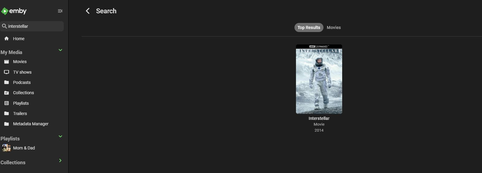

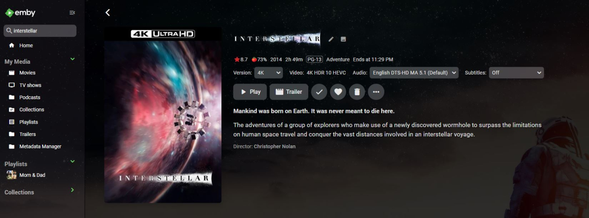

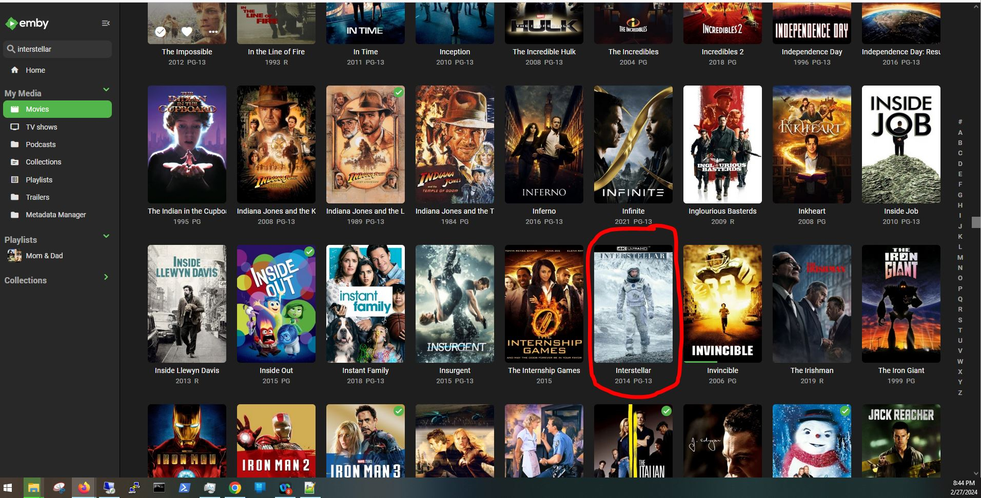

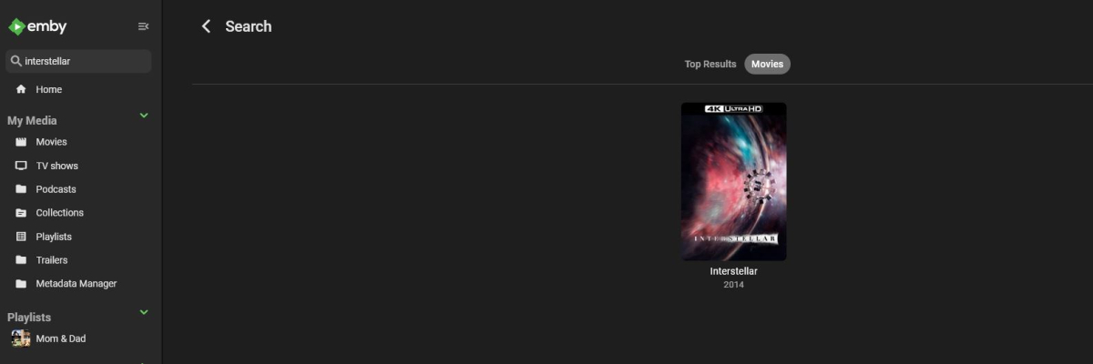

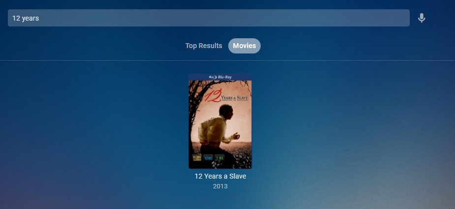

achalmers 3 Posted February 28, 2024 Author Posted February 28, 2024 (edited) 15 minutes ago, Luke said: Hi, the search feature does not incorporate the date added value in to the results or the sorting of the results. What I would suggest instead to test is going to your movies library and explicitly sorting by date added. That will be the best way to see the changes reflected. Yea I did and it wasnt being added to the top. What I'm saying is I knew I needed to edit the "date added field" and I searched for the title instead of sorting by Title and scrolling to the movie. For example, in the below 2 attachments the first result is not the same as the result under the "movies" tab within the search result. Updated the object under the "Top Results" section is not updating the movie shown in my library. When I shift over to the result under "movies" and edit that one, its actually updating the file in my library and then pushing it to the top. I dont know what the first object is. When I click it its still pointing to my MKV files yet if I manually scroll through my library there is only 1 Interstellar entry and its the second object (different cover art) Edited February 28, 2024 by achalmers more info

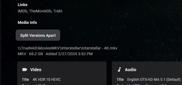

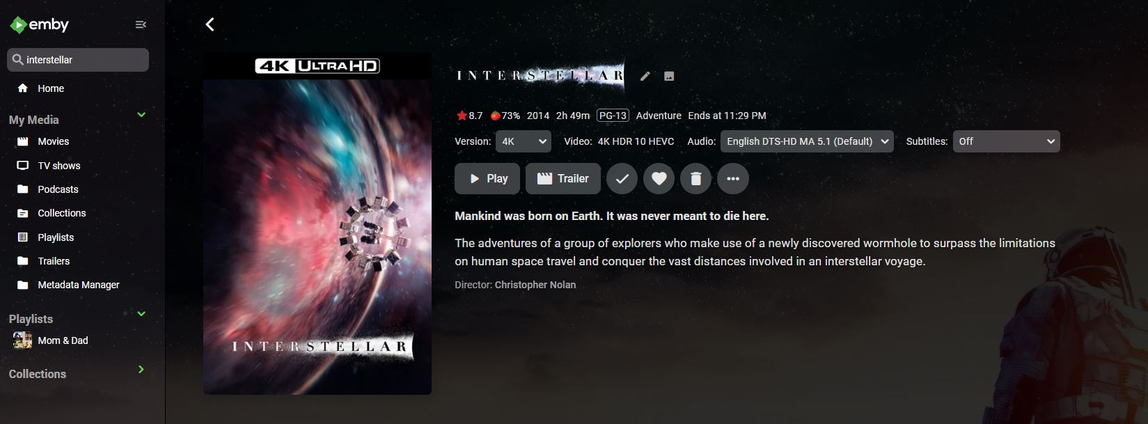

achalmers 3 Posted February 28, 2024 Author Posted February 28, 2024 2 minutes ago, Luke said: Do you have more than one copy of that movie? I do. Both within the same folder called "Interstellar" and one titled "Interstellar - 1080p" and another titled "Interstellar - 4K" I assumed this was operator error but the more I mess with it the more I'm not sure what the search results are actually showing me. As you can now see the search results still show me 2 different objects (different cover art) if I select "Top Results" vs "Movies". However if I sort by title and manually scroll to the movie there is only 1 with both files contained and select-able via the version dropbox. Here are some interesting finds. Both results when selected are referencing the same MKV files but they have different time stamps. Final picture shows only the 1 when you browse by title
achalmers 3 Posted February 28, 2024 Author Posted February 28, 2024 (edited) 8 minutes ago, Happy2Play said: Replicated with multi-version split apart changed image on one and rejoined. Sort of to be expected depending on what item become primary. Possibly a cached image issue. This jives. While these titles do now have multiple versions they didnt previously. Originally only a 1080p version. I put them in folders and renamed them in accordance with the Emby documentation and added the 4K files via the naming convention. So yea these were previously single version movies but now are combined. Edited February 28, 2024 by achalmers
Happy2Play 9799 Posted February 28, 2024 Posted February 28, 2024 Do you save images with media? But for my example you look in browser console and see each with a different itemnumber.
