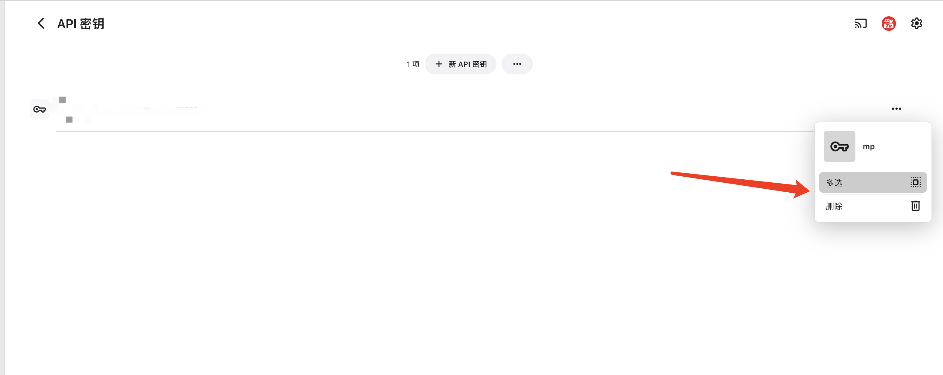

BIgdongdong1028 6 Posted May 28, 2024 Author Posted May 28, 2024 42 minutes ago, Luke said: HI, what do you feel is laggy? After just restoring a full backup, everything is lagging. leaving it alone for a night.now it's much better, because the library path is different, so I deleted the media library and rebuilt it. So far everything seems to be working fine, Only the copy icon for the API key has disappeared, why?
Lessaj 486 Posted May 28, 2024 Posted May 28, 2024 6 hours ago, BIgdongdong1028 said: After just restoring a full backup, everything is lagging. leaving it alone for a night.now it's much better, because the library path is different, so I deleted the media library and rebuilt it. So far everything seems to be working fine, Only the copy icon for the API key has disappeared, why?
