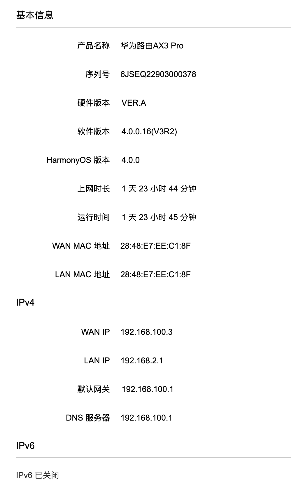

qinyuyaoluo 0 Posted February 26, 2024 Author Posted February 26, 2024 6 hours ago, Luke said: Are you using any kind of custom DNS? That would also cause it. You could also try turning off ipv6 in your router. I did not use custom DNS, and I do not have IPv6. However, my local network is a secondary router, and both routers are physical machines. The main router is 192.168.100.1. I set the secondary router as the DMZ host in the main router, and the secondary router's IP address is 192.168.2.1. Then I set up port forwarding on the secondary router to expose Emby to the Internet. But this should not affect Emby's ability to fetch image information, right? I can access image.tmdb.org on my NAS, but Emby itself keeps timing out. I am at a loss for what to do.
Luke 42241 Posted February 26, 2024 Posted February 26, 2024 Quote and I do not have IPv6. Can you still try disabling it in your router?
qinyuyaoluo 0 Posted February 27, 2024 Author Posted February 27, 2024 11 hours ago, Luke said: Can you still try disabling it in your router? The option is disabled on both routers, and I feel like I'm going to collapse.
qinyuyaoluo 0 Posted February 27, 2024 Author Posted February 27, 2024 8 minutes ago, Luke said: What kind of routers? Huawei Router
