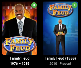

Actually, doesn't look like it's picking up the series correctly. Says 1976 to 1985 below.
How do I correct this confusion?

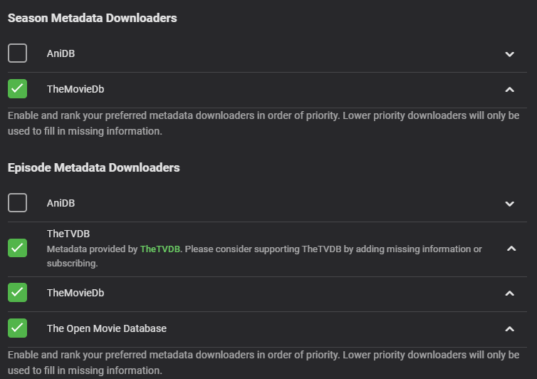

HI, what metadata fetchers are enabled on the library and in what order?

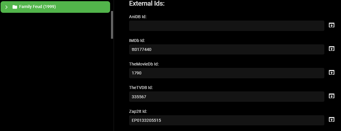

What do both of those series have for external ids in the metadata editor?
Presumably it's matching on Family Feud 1976 because in the guide the series name is "Family Feud", which matches to https://thetvdb.com/series/family-feud. Rather than Family Feud (1999) which would match to https://thetvdb.com/series/family-feud-1999.
It does recognize that the series episodes are party of Season 25, but since the series ID is wrong no episode information is pulled in. It's just a video name "##" (the episode number) in the episode folder.
Ideally I would be able to override the series id in the recording configuration, using the same Identify functionality that exists elsewhere.
