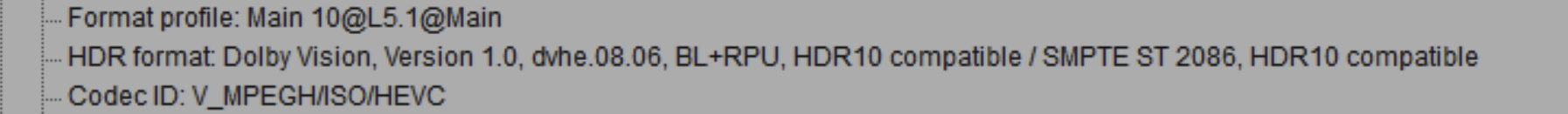

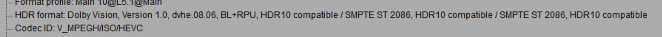

kaledi 42 Posted February 22, 2024 Posted February 22, 2024 I've noticed that some DV files re-encoded by Handbrake are not correctly flagging DV playback correctly - tested on Fire TV Max and Shield TV pro (2019). It appears that the current version of Handbrake is adding multiple references to HDR into the HDR format field (visible in mediainfo). If I demux the DV metadata out and reinfect it in, the field is looks normal and the file correctly flags the playback device to play DV. I don't know if this is a bug in Handbrake (I'll ask in their forums), and don't know technically what this means, and whether a simple fix can be applied to emby, but I suspect there will be a lot of such encodes out there. I can post a couple of sample files to help.

kaledi 42 Posted February 25, 2024 Author Posted February 25, 2024 I know, familiar, and frustrating! For anyome else experiencing something similar, I've found that demuxing and remuxing these files solves the issues and all media I've trued has played perfectly since. Specifcally, I've used Dolby Vision tool to demux the base layer and DV layer, remux them back together and add audio and subtitles from the original file using mkvtoolnix. A bit of a pain, but as I said at the top , it has worked for every file for me. I even had a couple that were causing emby to playback errors causing a re-encode on the server.
rbjtech 5335 Posted February 26, 2024 Posted February 26, 2024 I continue to believe it's a bug in handbrake - as none of the tooling from mkvtoolnix nor a flat remux from ffmpeg has issues. If they follow suit, and we get a new 'standard' then fine - emby will need to follow - but at the moment, handbrake need to fix it, not emby imo.
