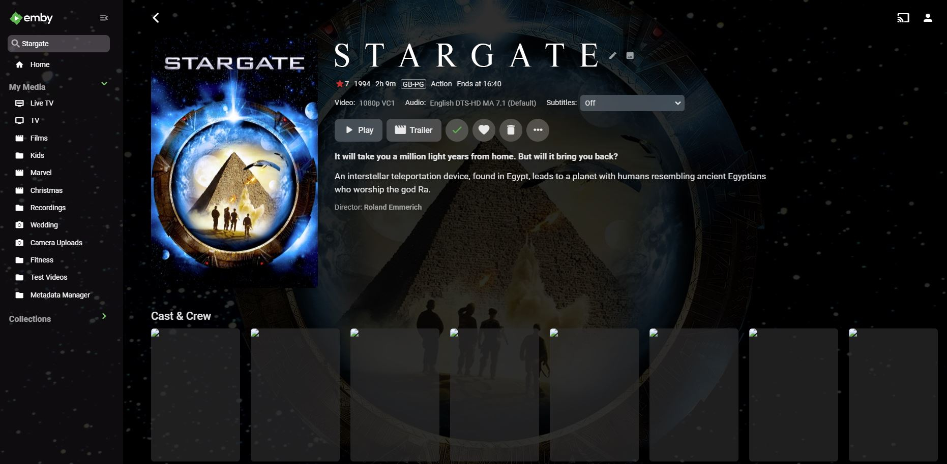

NickHill1982 0 Posted February 22, 2024 Posted February 22, 2024 Hi There, I recently migrated from Windows Server 2022 to Unraid. - I may have caused this problem myself buy doing a backup and restore and then changing paths. but essentially when I search for media I get 2 results back. 1 as it should look on the new path and 1 on the old path (essentially a dead link) The new path starts "/mnt/" and the old path starts "d:\plex\" (please excuse the plex, I used to use it before I migrated to emby) is there a way I can delete any link to old non existing content that links to "d:\plex ? Please see attached pics and logs I do also have a problem with the cast and crew (attached, but happy to raise that on a different thread) embyserver.txt

NickHill1982 0 Posted February 23, 2024 Author Posted February 23, 2024 Further to the above post... if I try and delete one of them manually I get the attached error
