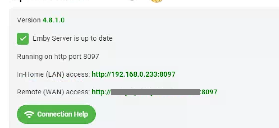

Riptide126 24 Posted February 21, 2024 Posted February 21, 2024 (edited) I recently made some changes to my server, I am no using a reverse proxy (nginx) and running both jellyseerr and emby through it, as well as a custom domain. One problem I am having is that google is flagging my domain for some reason, I went ahead and proved ownership of the domain and hopefully that will solve itself through them, I am assuming you guys have nothing to do with that. My other issue is that remote access is running through http instead of https those are my network setting as of right now, I can also show you my folder with my ssl certificates in them. I tried my best to follow the guide for setting up dns on emby, there is two different .pfx files in there, one that was created using winacme and the other using openSSL to create a PKCS#12 cert file. I am honestly super new to all of this so it is highly likely I am doing something wrong, any help would be appreciated. Edited February 21, 2024 by GrimReaper Domain masked
pwhodges 2023 Posted February 21, 2024 Posted February 21, 2024 (edited) If you are now running through a reverse proxy, that is where your https end-point is. You need to set up the certificate in the reverse proxy. Having an http link from the reverse proxy to the actual server is then expected (setting up a local https link is a separate operation, and typically not as easy as a public one). You tell Emby that the reverse proxy is handling https, so that it can still use the correct WAN url. Paul Edited February 21, 2024 by pwhodges 1

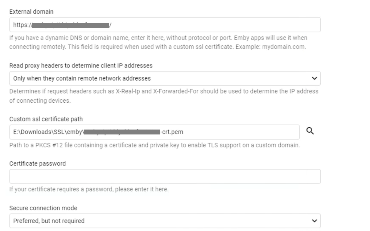

Riptide126 24 Posted February 21, 2024 Author Posted February 21, 2024 (edited) Thank you guys so much for you help, I ended up getting it working so what I have attached is what it says now, the only issue that I have now is that when I type that into google it says the website is dangerous, I went on google search console and claimed the domain name and subdomain, however I am wondering what the reason is that it is saying that the site is dangerous, as I have jellyseerr set up with the same domain just [redacted] and it doesnt give me that warning. Edited February 21, 2024 by GrimReaper Domain masked

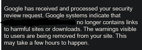

darkassassin07 670 Posted February 21, 2024 Posted February 21, 2024 A somewhat common issue. Just googles automations being a PITA. Not much to do but report it as a false positive.
Riptide126 24 Posted February 21, 2024 Author Posted February 21, 2024 That is insane timing, I just logged into the search console and got this from google, hopefully that is the end of that issue but from what I have seen from others I have a feeling that the issue is gonna come back. 1
