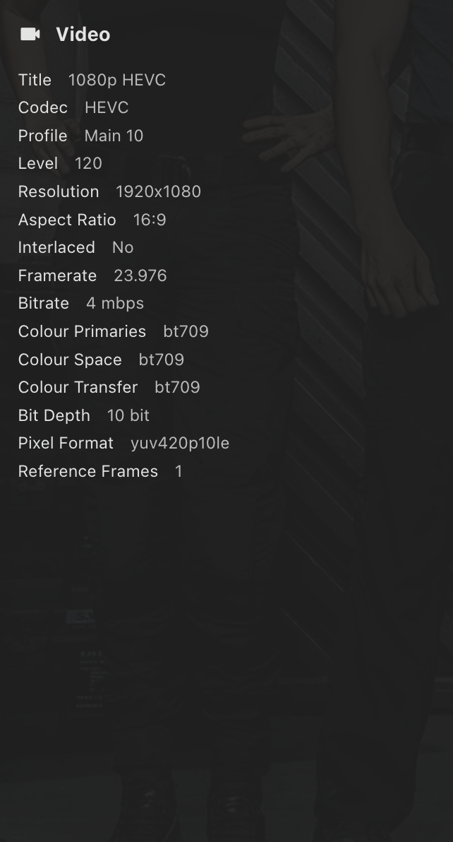

Central12 1 Posted February 18, 2024 Author Posted February 18, 2024 Here are some examples of the content that I'm receiving these issues on
