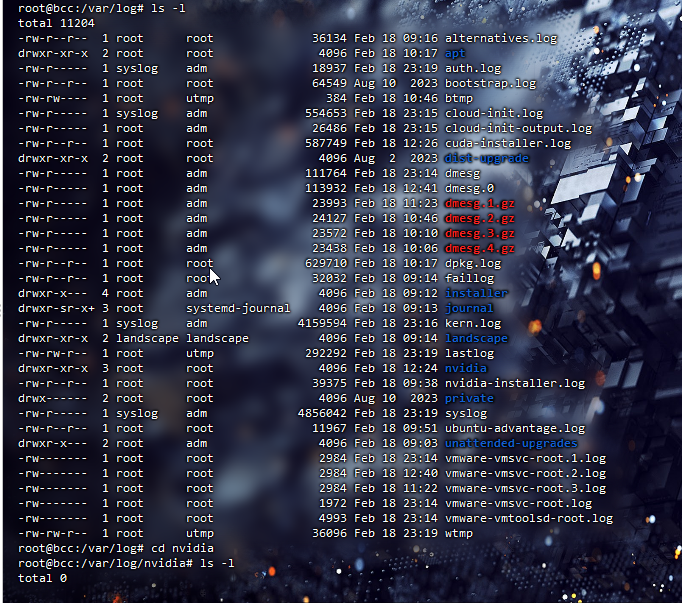

bzmjcster 0 Posted February 18, 2024 Author Posted February 18, 2024 我购买了Emby Premiere 密钥的。emby运行速度很慢,不能正常使用了,nvidia驱动也是正常安装好了的,但是emby不能使用nvidia解码呢。 nvidia-installer.log embyserver (2).txt embyserver-63843894943.txt
bzmjcster 0 Posted February 18, 2024 Author Posted February 18, 2024 我找不到运行日志,而且emby启动运行十分缓慢,不能流畅使用emby,不知道什么原因啊?

bzmjcster 0 Posted February 19, 2024 Author Posted February 19, 2024 It has already been uploaded, is it a graphics card driver permission issue? Where should I set it up? Thank you!
