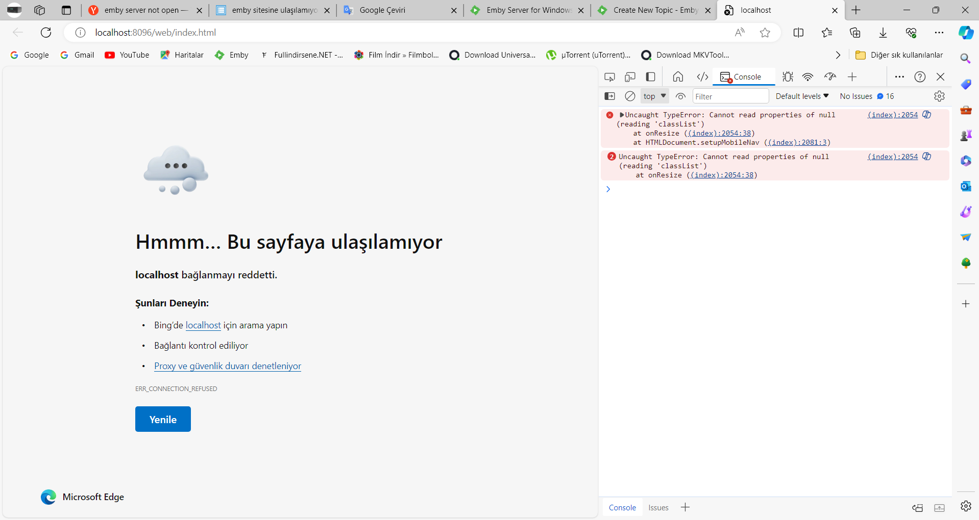

manisa79 2 Posted February 18, 2024 Posted February 18, 2024 Hello; I moved from HPGen8 server to HPGen10 Plus V2 server with a clean installation of Windows 11. I transferred all the disks and I was ready. I installed Emby Server. But that's it, I can't access the sausage settings and I can't make any adjustments. I use Edge, which comes with Windows 11, as a browser. Why can't I reach my Emby server?
Happy2Play 9799 Posted February 18, 2024 Posted February 18, 2024 Is EmbyServer still running in taskmanager? But sounds like server has crashed leaving tray icon running. Are there errors related to Emby in Event Viewer? Many need to see the server log also.
manisa79 2 Posted February 18, 2024 Author Posted February 18, 2024 (edited) The strange thing is that it works normally on my old server (HPGen8), but it does not work on my new server (HPGen10 Plus V2). The operating system is Windows 11 Pro on both servers, and the user is the same on both servers. When I copy the emby server files from the old server to the new server, the emby server works. The problem is that the emby server does not start only when the server is turned off and on again or restarted for any reason. Although it is visible in the initial settings. It works normally except that the server does not start when the PC is turned on. However, I cannot access the emby server in a clean installation. Frankly, I still don't understand why it happened. I don't know if there is anyone using an HP Gen10 Plus V2 server and not having any problems. I am adding the log files I can find in the Emby installation folders. Thank you very much for your interest. Emby.zip Edited February 18, 2024 by manisa79
manisa79 2 Posted February 18, 2024 Author Posted February 18, 2024 I solved the problem. The problem was that I accidentally added a letter to my username when setting up my server. Thank you everyone for your help. I'm sorry for keeping you busy. 1
