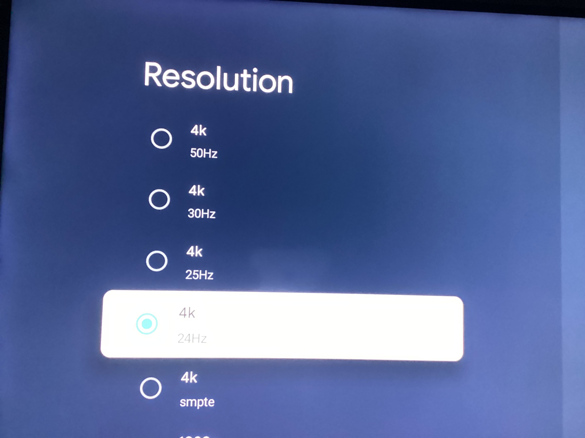

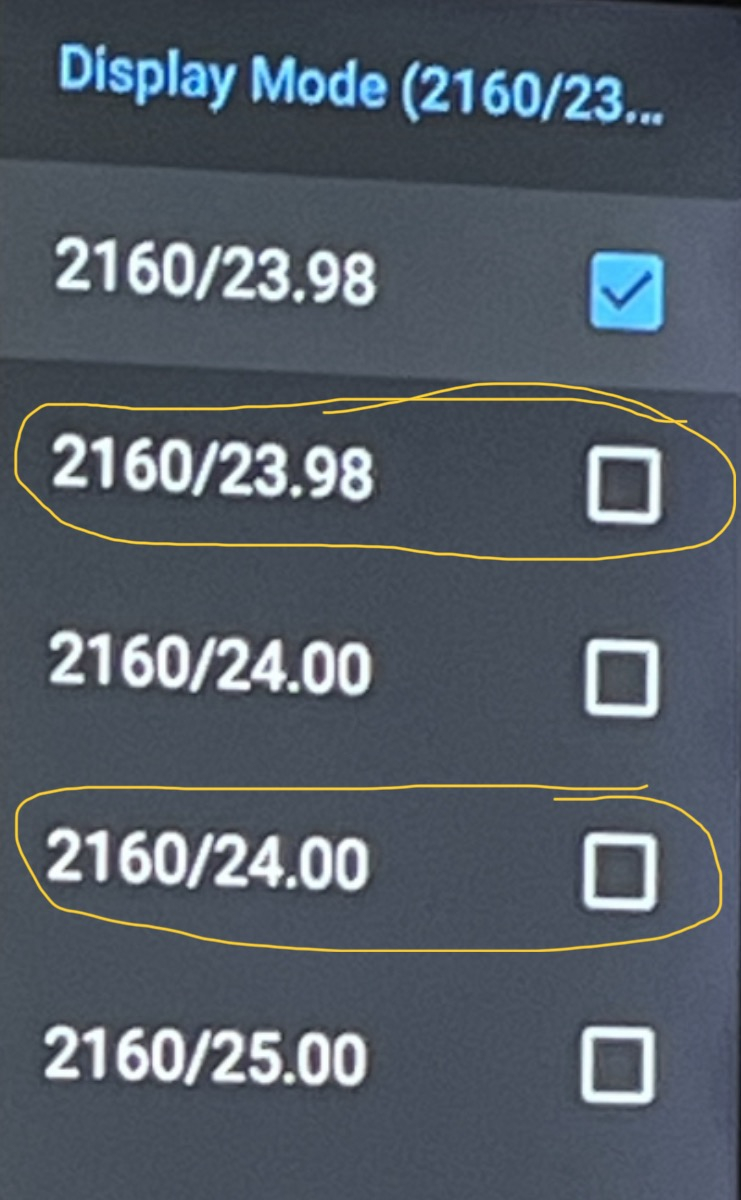

freddyfinn 9 Posted February 18, 2024 Posted February 18, 2024 (edited) I have an issue with the app not switching refresh rate correctly. The screen flickers then reports it is using the correct refresh rate yet the picture stutters badly. When I go into settings > display mode I get duplicate refresh rates see pictures. This doesn’t happen on my Nvidia Shield units. if I select the second refresh rate the screen flickers again and changes correctly and playback is smooth. Eg switch from 2160/23.98 to the same below. The only time it doesn’t do it is when you match content resolution and resolution is below 2160p. Duplicate refresh rates are constantly there as are various others at 2160p. Edited February 18, 2024 by freddyfinn Spelling

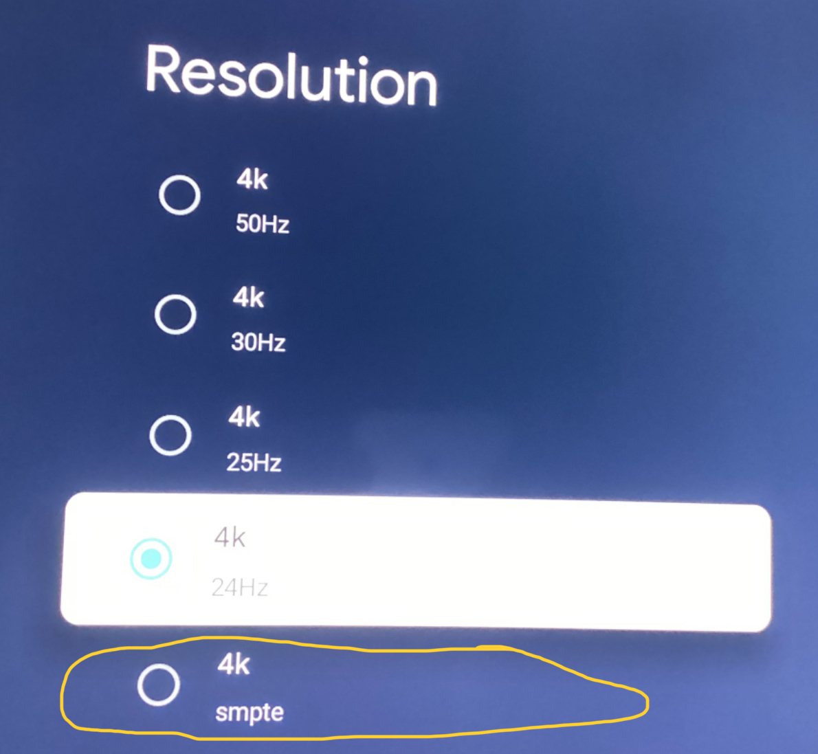

freddyfinn 9 Posted May 20, 2024 Author Posted May 20, 2024 @ebrseems emby needs to trigger 4K smpte 4096x2160 /24/25/30/50/60 when changing frame rates. Instead it seems to be going for 3840x2160p which does not switch the tv frame rate even though emby flickers and shows it has. Smpte seems to be the only way to switch the display frame rate correctly. The duplicates are as per the picture. 3840x2160p 24/25/30/50/60. - device resolutions DO NOT have any affect on switching the TV FRAME RATE. 4Ksmpte Comprises the following rates ALL SWITCH TV FRAME RATE CORRECTLY. 4096x2160 /24/25/30/50/60 Emby is seeing 4Ksmpte as 3840x2160p causing duplicates to be created. .

freddyfinn 9 Posted June 2, 2024 Author Posted June 2, 2024 17 hours ago, Luke said: Hi, what do you mean by change it manually? Change what exactly? @Lukeas per the pictures I posted earlier showing duplicated resolutions if I move the resolution to the second duplicate manually the TV switches to full resolution of 4096x2160p True 4K as opposed to 3840x2160p UHD The circled resolutions below are 4096p however I have to pop up settings in the player and select them manually. I believe 4096p is only available on the Google TV when the TV supports enhanced HDMI. When it does another resolution becomes available in the Google TV settings which is 4K smpte which is exclusively for full 4096p or True 4K. If the TV does not support enhanced HDMI @4096p there will be no duplicate entries in Emby and no 4K smpte available in the Google TV settings.
