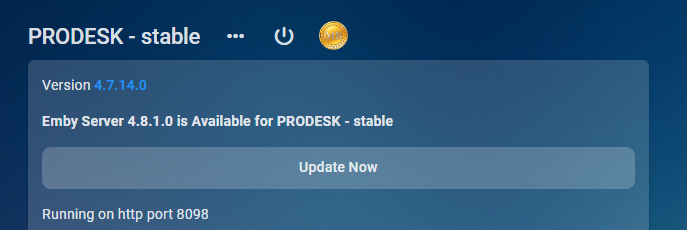

lick2023 1 Posted February 18, 2024 Posted February 18, 2024 After restarting, it will be updated to 4.8.1, but the update is not successful. It keeps getting stuck on this page for 1-2 minutes and will not jump to the homepage. When opening the website in a new window, it will display "reject connection". If not restarted, everything is normal!
Luke 42288 Posted February 18, 2024 Posted February 18, 2024 Hi there, what version are you upgrading from?
lick2023 1 Posted February 18, 2024 Author Posted February 18, 2024 4.7.14, the final version of 4.7, restarting it will automatically update it, and then it cannot be restarted, unable to update!

lick2023 1 Posted February 18, 2024 Author Posted February 18, 2024 问题是,只要恢复到4.7.14,就会自动更新到4.8.1,无法访问最新版本!

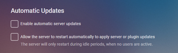

lick2023 1 Posted February 18, 2024 Author Posted February 18, 2024 Can you set it to not update to version 4.8.1 after rebooting? If it is cancelled in the background, it will still be updated to the latest version. Restart!
Happy2Play 9814 Posted February 18, 2024 Posted February 18, 2024 3 minutes ago, lick2023 said: Can you set it to not update to version 4.8.1 after rebooting? If it is cancelled in the background, it will still be updated to the latest version. Restart! Sort of as you just disable auto update but by the time you get there at startup it is already downloaded and has to be deleted from update folder After that you will just a button on dashboard that you never click. But eventually you will have to update.
lick2023 1 Posted February 18, 2024 Author Posted February 18, 2024 Thank you, yes, so how can we solve this problem? The update won't start, and not updating won't work, which is very troublesome!
