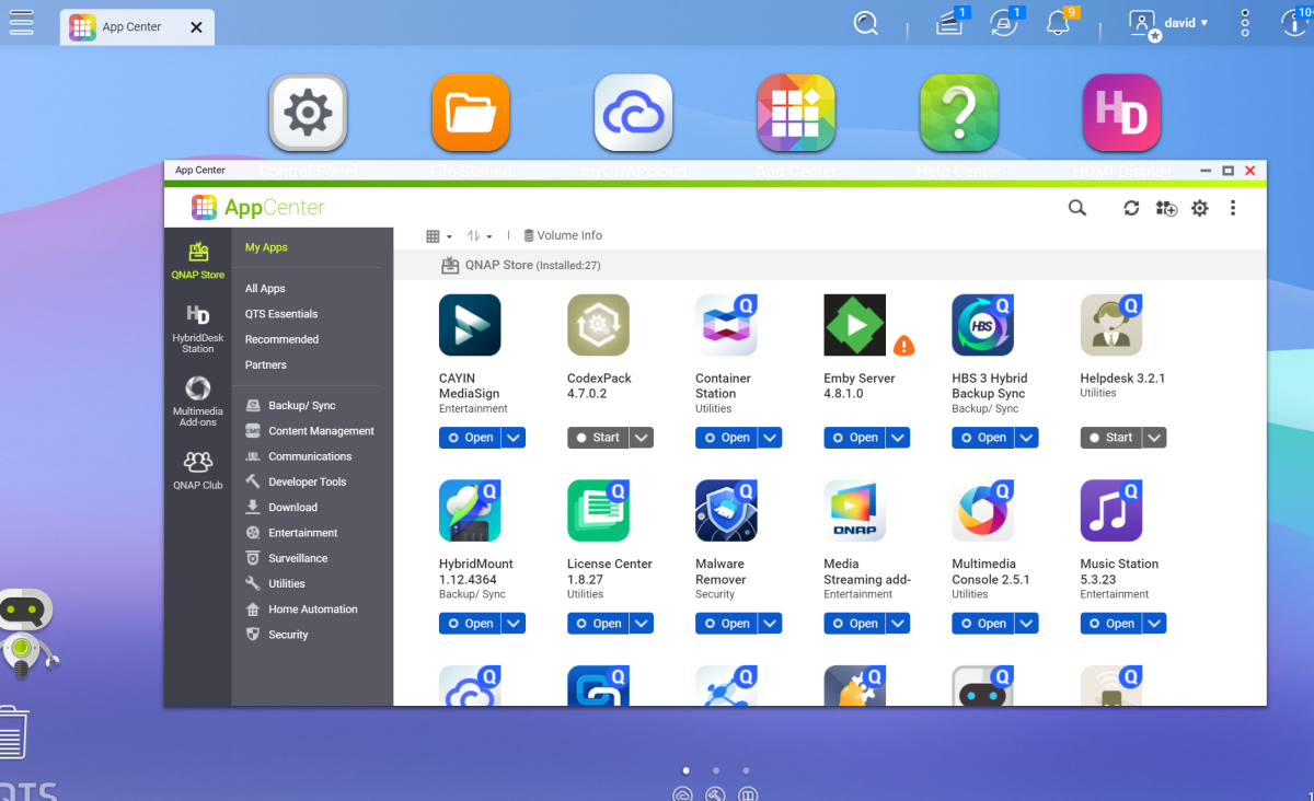

MrGiles 2 Posted February 17, 2024 Author Posted February 17, 2024 I don't understand - according to the Appcenter on my NAS, the Emby version currently installed is 4.8.1.0. I downloaded the package from your website and installed it manually, and I've just re-installed it now to make sure (see screenshot). I still can't open Emby in Windows - it won't get past the splash screen. I've used the Theatre app to get to the logs, and an updated log is attched - but I think this still shows v4.7.14.0 embyserver 17-02-24.txt
