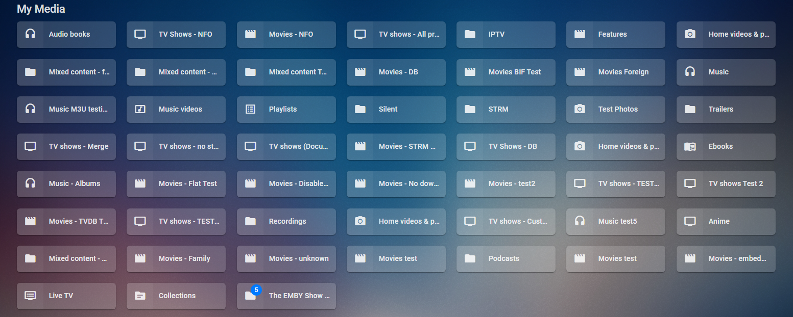

Happy2Play 9799 Posted February 16, 2024 Posted February 16, 2024 Better example full screen no scroll adjust screen changes to scroll But to handle lower resolutions a lower em, @media (pointer:fine) and (min-width:80em) {.itemsContainer-finepointerwrap { -webkit-flex-wrap: wrap; flex-wrap: wrap; } .itemsContainer-finepointerwrap.itemsContainer-sideFooters:not(.virtualItemsContainer) { -webkit-flex-direction: row; flex-direction: row; height: auto; max-height: initial; } }
ebr 16307 Posted February 16, 2024 Posted February 16, 2024 4 hours ago, Happy2Play said: Better example full screen no scroll adjust screen changes to scroll But to handle lower resolutions a lower em, @media (pointer:fine) and (min-width:80em) {.itemsContainer-finepointerwrap { -webkit-flex-wrap: wrap; flex-wrap: wrap; } .itemsContainer-finepointerwrap.itemsContainer-sideFooters:not(.virtualItemsContainer) { -webkit-flex-direction: row; flex-direction: row; height: auto; max-height: initial; } } And that example is an excellent illustration of why the order needs to change for a horizontal scroll. Thx.

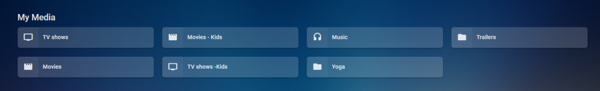

Happy2Play 9799 Posted February 17, 2024 Posted February 17, 2024 1 hour ago, ebr said: And that example is an excellent illustration of why the order needs to change for a horizontal scroll. Thx. True I can see from a lot of libraries, but previous example make it look like there is an issue. Where there have been other topics on this min-width option being issues on all older 1366 displays.

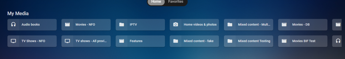

Happy2Play 9799 Posted February 17, 2024 Posted February 17, 2024 9 minutes ago, beckfield said: Could you explain that, please? I'm not intending to argue against it - I just don't understand what it is that makes it important for the order to change. For me, it just shows the impracticality of horizontal scrolling, regardless of how the ordering goes. Full screen will go left to right without scroll, but once scrolling is initiated due to resolution it changes to top to bottom. But the issue is it is not as noticeable when you only have a few libraries. My previous images with few libraries do not show the scroller like the large test system.
