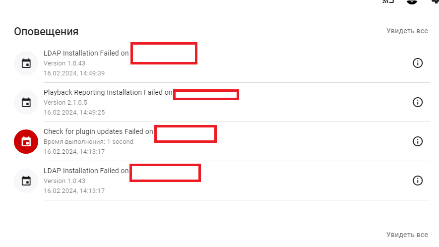

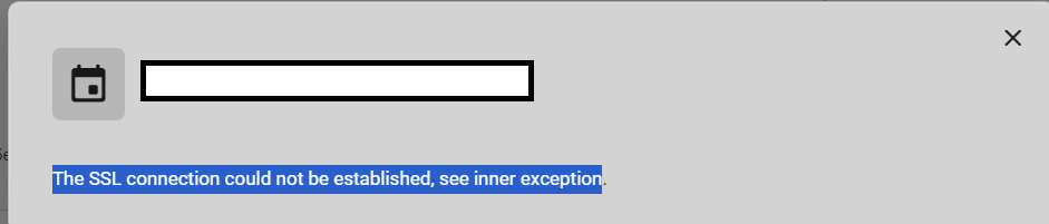

Santrex 7 Posted February 15, 2024 Posted February 15, 2024 Good afternoon. Tell me I have this problem. I upgraded to the latest version of Server for Windows and I have a problem updating current Plugins to new versions. Error below: Check for plugin updates Failed on ********** The SSL connection could not be established, see inner exception. at Emby.Server.Implementations.HttpClientManager.CoreHttpClientManager.GetTempFileResponse(HttpRequestOptions options) at Emby.Server.Implementations.HttpClientManager.CoreHttpClientManager.GetTempFile(HttpRequestOptions options) at Emby.Server.Implementations.Updates.InstallationManager.PerformPackageInstallation(IProgress`1 progress, String target, PackageVersionInfo package, CancellationToken cancellationToken) at Emby.Server.Implementations.Updates.InstallationManager.InstallPackageInternal(PackageVersionInfo package, Boolean isPlugin, IProgress`1 progress, CancellationToken cancellationToken) at Emby.Server.Implementations.Updates.InstallationManager.InstallPackage(PackageVersionInfo package, Boolean isPlugin, IProgress`1 progress, CancellationToken cancellationToken) at Emby.Server.Implementations.ScheduledTasks.PluginUpdateTask.Execute(CancellationToken cancellationToken, IProgress`1 progress) at Emby.Server.Implementations.ScheduledTasks.ScheduledTaskWorker.ExecuteInternal(TaskOptions options)

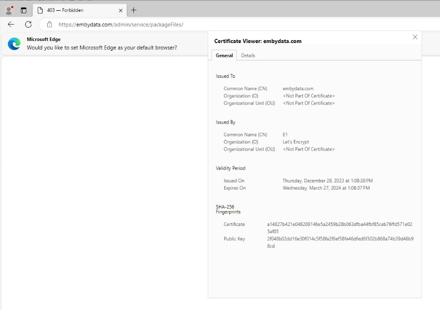

Lessaj 479 Posted February 16, 2024 Posted February 16, 2024 I see basically 2 errors in your log, either "UntrustedRoot" or "NotTimeValid, UntrustedRoot". The certificate being used is signed by Let's Encrypt, which should be on all systems already. I'm surprised to see NotTimeValid because these are 3 month rolling certs, it should have been renewed at the end of December. Can you try going to this URL in your browser? Have you made any modifications to the default certificate stores on your system? 2024-02-16 14:49:39.625 Error HttpClient: Error getting response from https://embydata.com/admin/service/packageFiles/LDAP.dll_1.0.43.exe System.Net.Http.HttpRequestException: System.Net.Http.HttpRequestException: The SSL connection could not be established, see inner exception. ---> System.Security.Authentication.AuthenticationException: The remote certificate is invalid because of errors in the certificate chain: NotTimeValid, UntrustedRoot Certificate chain 0 s:CN=embydata.com i:C=US, O=Let's Encrypt, CN=E1 a:PKEY: id-ecPublicKey, 256 (bit); sigalg: ecdsa-with-SHA384 v:NotBefore: Dec 28 10:08:38 2023 GMT; NotAfter: Mar 27 10:08:37 2024 GMT 1 s:C=US, O=Let's Encrypt, CN=E1 i:C=US, O=Internet Security Research Group, CN=ISRG Root X2 a:PKEY: id-ecPublicKey, 384 (bit); sigalg: ecdsa-with-SHA384 v:NotBefore: Sep 4 00:00:00 2020 GMT; NotAfter: Sep 15 16:00:00 2025 GMT 2 s:C=US, O=Internet Security Research Group, CN=ISRG Root X2 i:C=US, O=Internet Security Research Group, CN=ISRG Root X1 a:PKEY: id-ecPublicKey, 384 (bit); sigalg: RSA-SHA256 v:NotBefore: Sep 4 00:00:00 2020 GMT; NotAfter: Sep 15 16:00:00 2025 GMT 3 s:C=US, O=Internet Security Research Group, CN=ISRG Root X1 i:O=Digital Signature Trust Co., CN=DST Root CA X3 a:PKEY: rsaEncryption, 4096 (bit); sigalg: RSA-SHA256 v:NotBefore: Jan 20 19:14:03 2021 GMT; NotAfter: Sep 30 18:14:03 2024 GMT
Santrex 7 Posted February 19, 2024 Author Posted February 19, 2024 Yes, I was able to follow the links and it works as expected: https://embydata.com/admin/service/packageFiles/LDAP.dll_1.0.43.exe Judging by the certificate and access to the Site, there are no problems there. (this is from the machine running EMBY Server)
