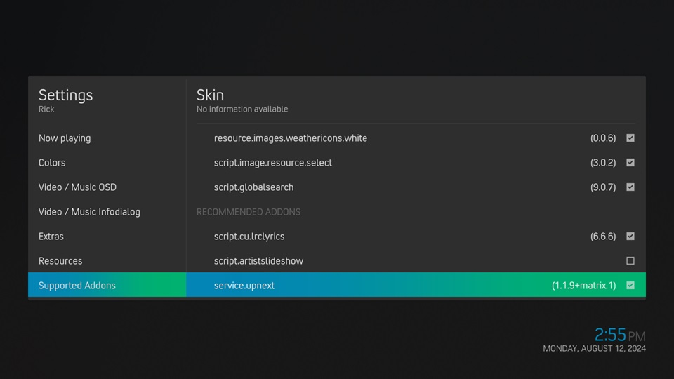

FrostByte 5453 Posted August 12, 2024 Posted August 12, 2024 5 hours ago, supermood said: Good news that it's working! Thanks! And confusing. I'm with arctic zephire reloaded, the addon is turned on, the test pop up in the settings is working. But that's it. Do you have any other relevant settings in emby or the skin? I can't see any addon settings that I changed from default other than the Fancy popup box. In skin settings is this checked? 1
supermood 71 Posted August 12, 2024 Posted August 12, 2024 Thanks. Yes it's on. Strange .. bad luck maybe
FrostByte 5453 Posted August 12, 2024 Posted August 12, 2024 40 minutes ago, supermood said: Thanks. Yes it's on. Strange .. bad luck maybe It looks like development on the plugin has stopped, but someone has created a fork of it and is making updates. Seems to be working if you want to try it. https://github.com/MoojMidge/service.upnext 2

supermood 71 Posted August 13, 2024 Posted August 13, 2024 12 hours ago, FrostByte said: It looks like development on the plugin has stopped, but someone has created a fork of it and is making updates. Seems to be working if you want to try it. https://github.com/MoojMidge/service.upnext THANK YOU!! I googelt upnext 100 times never saw that. Will def try!! happy day!
supermood 71 Posted August 13, 2024 Posted August 13, 2024 13 hours ago, FrostByte said: It looks like development on the plugin has stopped, but someone has created a fork of it and is making updates. Seems to be working if you want to try it. https://github.com/MoojMidge/service.upnext installed it many thanks! but still no pop up... maybe a skin helper or one of these other addon are missing / corrupted who knows.. I will survive without it...
