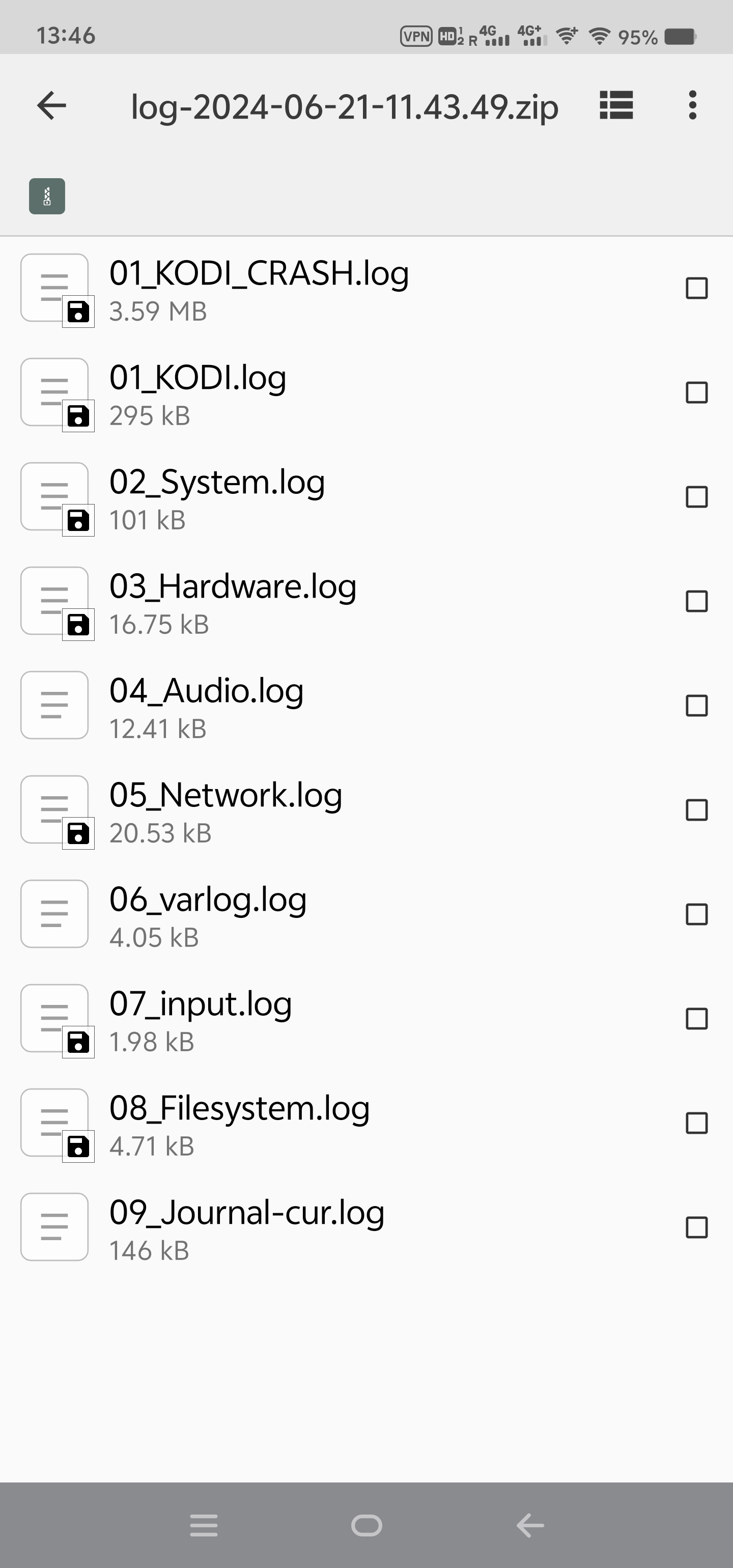

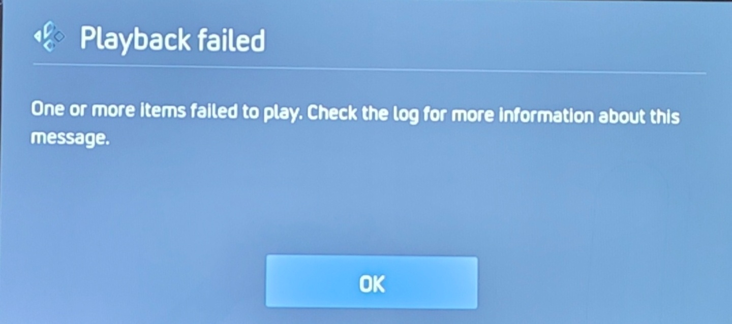

supermood
hi quickmic,
happened again, file cannot be played after I was checking the completeness of a boxsets or browsing through movie lists. after a reboot the movie plays perfectly.
which log do you need? mans thanks and best, d
Screenshot_20240621_134944.thumb.jpg.d663d11cc5c4e314599cd4363e626414.jpgScreenshot_20240621_134634.thumb.jpg.a91d854a972a9641bb8ddf766fcf0acc.jpg
