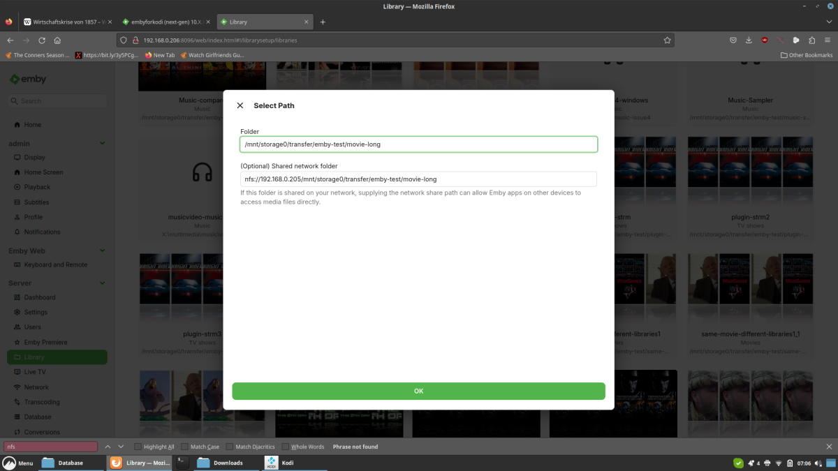

quickmic 1709 Posted June 13, 2024 Author Posted June 13, 2024 (edited) 3 hours ago, DarWun said: Stupid question. But how do I force an update of the sources.xml file? I've done testing over the last few days that added and removed path locations from the libraries. But the source.xml file is dated three days prior. It doesn't seem to get updated as I make changes. The optional paths aren't listed in the file even though they are set in the library. Edited to add: I deleted the sources.xml file expecting that Kodi would recreate it on the next startup. It did not. I then did an E4K database reset. After doing that and adding the libraries, the sources.xml file was created. But what I'm seeing in it does not reflect path locations set for my libraries in Emby. the "nfs:..." optional location I added for the movie library is not shown at all. kodi.log 7.25 MB · 0 downloads Your observation is absolutely correct. The plugin doesn't delete the sources, there is no need for. It just adds additional records if they don't exist and only on factory resets. Additional paths are usually used for playing not Emby related content -> native Kodi content. If I would rebuild the sources from scratch, people will (and have) complained about that. I still need the "invalid" sources.xml for review (including your custom records, braking the playback). btw, I see an issue in you last uploaded kodi.log. I assume it's a log from stock .29 plugin? I'll check and fix it, seems to be related to transcoding. Edited June 13, 2024 by quickmic 1

DarWun 357 Posted June 13, 2024 Posted June 13, 2024 (edited) 17 hours ago, quickmic said: I still need the "invalid" sources.xml for review (including your custom records, braking the playback). btw, I see an issue in you last uploaded kodi.log. I assume it's a log from stock .29 plugin? I'll check and fix it, seems to be related to transcoding. Thanks for explaining that. The image of the sources.xml file I provided in my last post is from the broken playback attempt. I was confused by the fact that I wasn't actually seeing a "nfs"\\..." source item in the sources.xml file even though it was specified for the library of the media file that failed to play. I'll provide the actual log when I get home from work later tonight. As to your quest about which version of the plugin the last kodi.log I provided is linked to. You are correct. It is a log from the stock E4K .29 plugin. I'll update to .30 before doing any additional testing. Edited June 13, 2024 by DarWun

DarWun 357 Posted June 14, 2024 Posted June 14, 2024 (edited) On 6/12/2024 at 11:36 PM, quickmic said: I still need the "invalid" sources.xml for review (including your custom records, braking the playback). btw, I see an issue in you last uploaded kodi.log. I assume it's a log from stock .29 plugin? I'll check and fix it, seems to be related to transcoding. "Invalid" sources.xml file attached (E4K .30). Debug Kodi.log attached from playback attempt (She-Hulk - S01E01). Library path location settings: sources.xml kodi.log Edited June 14, 2024 by DarWun
quickmic 1709 Posted June 15, 2024 Author Posted June 15, 2024 (edited) 11 hours ago, DarWun said: "Invalid" sources.xml file attached (E4K .30). Debug Kodi.log attached from playback attempt (She-Hulk - S01E01). Library path location settings: sources.xml 1.16 kB · 0 downloads kodi.log 7.82 MB · 0 downloads I used your sources.xml and a similar library. Still no issue on my setup, playback is flawless. Also I performed a test on windows, everything fine. Another test with a TV-Shows, also fine. I compared my (working) Kodi log with yours line by line. The only difference, you get timeouts while mine is perfect. At the moment I have no idea what's wrong/different on your setup and I cannot reproduce it. Also no idea why this should only happen on > .25 As mentioned, the next step would be testing with your server. I'm running out of options here on my setup. btw, I review again your emby server log (the .27 part only): 2024-06-07 17:41:36.001 Info Server: http/1.1 Response 200 to host2. Time: 2ms. POST http://192.168.0.13:8096/emby/Sync/Data?X-Emby-Client=Emby for Windows&X-Emby-Device-Name=DARWUN-PC&X-Emby-Device-Id=YjVTdvDbFxfYvfGIbmhC7BONQNxmnOSBrFWIjGZlvU&X-Emby-Client-Version=1.1.566.0&X-Emby-Token=x_secret4_x&reqformat=json 2024-06-07 17:44:27.417 Info Server: http/1.1 POST http://192.168.0.13:8096/Sessions/Capabilities/Full. Source Ip: host1, UserAgent: Emby for Kodi Next Gen/10.0.27 2024-06-07 17:44:27.436 Info Server: http/1.1 Response 204 to host1. Time: 18ms. POST http://192.168.0.13:8096/Sessions/Capabilities/Full 2024-06-07 17:44:28.060 Info CoverArt: image enhance of Movies took 0.000 seconds. 2024-06-07 17:44:28.762 Info CoverArt: image enhance of Collections took 0.000 seconds. 2024-06-07 17:44:29.434 Info CoverArt: image enhance of TV took 0.000 seconds. 2024-06-07 17:44:30.070 Info CoverArt: image enhance of Music took 0.000 seconds. 2024-06-07 17:46:21.568 Info App: Saving playlist file /volume1/Shares/Music/Playlists/HDHomeRun Digital Antenna.wpl 2024-06-07 17:46:36.011 Info Server: http/1.1 POST http://192.168.0.13:8096/Sessions/Capabilities/Full. Source Ip: host1, UserAgent: Emby for Kodi Next Gen/10.0.27 2024-06-07 17:46:36.012 Info Server: http/1.1 Response 204 to host1. Time: 1ms. POST http://192.168.0.13:8096/Sessions/Capabilities/Full 2024-06-07 17:46:36.699 Info CoverArt: image enhance of Movies took 0.000 seconds. 2024-06-07 17:46:37.337 Info CoverArt: image enhance of Collections took 0.000 seconds. 2024-06-07 17:46:38.325 Info CoverArt: image enhance of TV took 0.000 seconds. 2024-06-07 17:46:38.941 Info CoverArt: image enhance of Music took 0.000 seconds. 2024-06-07 17:51:38.914 Info Server: http/1.1 HEAD http://192.168.0.13:8096/videos/791666/stream. Source Ip: host1, Connection=keep-alive, Host=host3, User-Agent=Emby for Kodi Next Gen/10.0.27, Accept-Charset=utf-8, Accept-Encoding=gzip, Authorization=Emby Client="Emby for Kodi Next Gen", Device="Kodi%20%28LibreELEC%29", DeviceId="a5782669-e4a5-448c-80fa-8c12a10e9011", Version="10.0.27", Emby UserId="830506f670cb492593df1dc39c976875", Content-Type=application/json; charset=utf-8, Content-Length=121, X-Emby-Token=x_secret3_x 2024-06-07 17:51:38.925 Info Server: http/1.1 Response 200 to host1. Time: 11ms. HEAD http://192.168.0.13:8096/videos/791666/stream 2024-06-07 17:54:14.036 Info Server: http/1.1 POST http://192.168.0.13:8096/Sessions/Capabilities/Full. Source Ip: host1, UserAgent: Emby for Kodi Next Gen/10.0.27 2024-06-07 17:54:14.038 Info Server: http/1.1 Response 204 to host1. Time: 1ms. POST http://192.168.0.13:8096/Sessions/Capabilities/Full 2024-06-07 17:54:57.170 Info Server: http/1.1 POST http://192.168.0.13:8096/emby/Sessions/a079a66674632022c818826ce74723ba/Playing?ItemIds=791666&PlayCommand=PlayNow&X-Emby-Client=Emby Web&X-Emby-Device-Name=Chrome Windows&X-Emby-Device-Id=84499b7f-450a-4b5d-9bf6-cf655ec509c6&X-Emby-Client-Version=4.9.0.23&X-Emby-Token=x_secret1_x&X-Emby-Language=en-us. Source Ip: host2, UserAgent: Mozilla/5.0 (Windows NT 10.0; Win64; x64) AppleWebKit/537.36 (KHTML, like Gecko) Chrome/125.0.0.0 Safari/537.36 Edg/125.0.0.0 2024-06-07 17:54:57.210 Info Server: http/1.1 Response 204 to host2. Time: 40ms. POST http://192.168.0.13:8096/emby/Sessions/a079a66674632022c818826ce74723ba/Playing?ItemIds=791666&PlayCommand=PlayNow&X-Emby-Client=Emby Web&X-Emby-Device-Name=Chrome Windows&X-Emby-Device-Id=84499b7f-450a-4b5d-9bf6-cf655ec509c6&X-Emby-Client-Version=4.9.0.23&X-Emby-Token=x_secret1_x&X-Emby-Language=en-us 2024-06-07 17:54:57.380 Info Server: http/1.1 HEAD http://192.168.0.13:8096/videos/791666/stream. Source Ip: host1, Connection=keep-alive, Host=host3, User-Agent=Emby for Kodi Next Gen/10.0.27, Accept-Charset=utf-8, Accept-Encoding=gzip, Authorization=Emby Client="Emby for Kodi Next Gen", Device="Kodi%20%28LibreELEC%29", DeviceId="a5782669-e4a5-448c-80fa-8c12a10e9011", Version="10.0.27", Emby UserId="830506f670cb492593df1dc39c976875", Content-Type=application/json; charset=utf-8, Content-Length=121, X-Emby-Token=x_secret3_x 2024-06-07 17:54:57.383 Info Server: http/1.1 Response 200 to host1. Time: 3ms. HEAD http://192.168.0.13:8096/videos/791666/stream 2024-06-07 17:57:04.702 Info Server: http/1.1 POST http://192.168.0.13:8096/Sessions/Capabilities/Full. Source Ip: host1, UserAgent: Emby for Kodi Next Gen/10.0.27 2024-06-07 17:57:04.704 Info Server: http/1.1 Response 204 to host1. Time: 1ms. POST http://192.168.0.13:8096/Sessions/Capabilities/Full 2024-06-07 17:57:52.001 Info Server: http/1.1 HEAD http://192.168.0.13:8096/videos/982864/stream. Source Ip: host1, Connection=keep-alive, Host=host3, User-Agent=Emby for Kodi Next Gen/10.0.27, Accept-Charset=utf-8, Accept-Encoding=gzip, Authorization=Emby Client="Emby for Kodi Next Gen", Device="Kodi%20%28LibreELEC%29", DeviceId="a5782669-e4a5-448c-80fa-8c12a10e9011", Version="10.0.27", Emby UserId="830506f670cb492593df1dc39c976875", Content-Type=application/json; charset=utf-8, Content-Length=121, X-Emby-Token=x_secret3_x 2024-06-07 17:57:52.003 Info Server: http/1.1 Response 200 to host1. Time: 3ms. HEAD http://192.168.0.13:8096/videos/982864/stream 2024-06-07 17:59:39.926 Info Server: http/1.1 POST http://192.168.0.13:8096/emby/Sessions/a079a66674632022c818826ce74723ba/Command?X-Emby-Client=Emby Web&X-Emby-Device-Name=Chrome Windows&X-Emby-Device-Id=84499b7f-450a-4b5d-9bf6-cf655ec509c6&X-Emby-Client-Version=4.9.0.23&X-Emby-Token=x_secret1_x&X-Emby-Language=en-us&reqformat=json. Source Ip: host2, UserAgent: Mozilla/5.0 (Windows NT 10.0; Win64; x64) AppleWebKit/537.36 (KHTML, like Gecko) Chrome/125.0.0.0 Safari/537.36 Edg/125.0.0.0 2024-06-07 17:59:39.950 Info Server: http/1.1 Response 204 to host2. Time: 24ms. POST http://192.168.0.13:8096/emby/Sessions/a079a66674632022c818826ce74723ba/Command?X-Emby-Client=Emby Web&X-Emby-Device-Name=Chrome Windows&X-Emby-Device-Id=84499b7f-450a-4b5d-9bf6-cf655ec509c6&X-Emby-Client-Version=4.9.0.23&X-Emby-Token=x_secret1_x&X-Emby-Language=en-us&reqformat=json Beside the DNS names (which sounds kind of odd) -> host1, host2 etc. did you really send remote commands to the via WebUi -> "PlayNow" EDIT: I found one http issue, not sure if related to your problem. I'll try to fix it in next version. Edited June 15, 2024 by quickmic 1
quickmic 1709 Posted June 15, 2024 Author Posted June 15, 2024 (edited) New BETA version available 10.0.31: Delta changelog 10.0.30 -> 10.0.31 fix connection issues with SubUrl connection strings (also fixes websocket issues behind proxies) fix wrong subtitle index fix http head requests Comment: resync is required to fix subtitle issues @DarWunThis version might fixes the playback issue you have. If so, remote content was affected. The HEAD requests had a bug and its used to verify remote content. Edited June 15, 2024 by quickmic 2
DarWun 357 Posted June 15, 2024 Posted June 15, 2024 (edited) 6 hours ago, quickmic said: New BETA version available 10.0.31: @DarWunThis version might fixes the playback issue you have. If so, remote content was affected. The HEAD requests had a bug and its used to verify remote content. It did indeed fix the issue I was having. Thanks @quickmic! Let me know if you want me to do any additional testing. I'm not sure why Emby is considering my content as "remote". It is all on my local network devices with remote access completely disabled (or so i thought). Edited June 15, 2024 by DarWun 1
