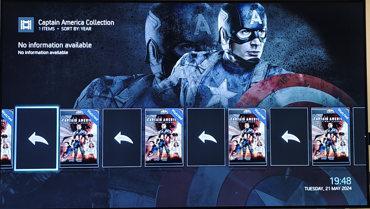

supermood 71 Posted May 21, 2024 Posted May 21, 2024 (edited) since update yesterday in movie list I don't have sets anymore every movie is a single item in the list. movie set is checked in video lib settings but no effect. any idea? anything I can do? many thanks!! edit : I thought maybe it was the change from dynamic lib to normal lib. but that was 2 days ago I still had sets. Edited May 21, 2024 by supermood

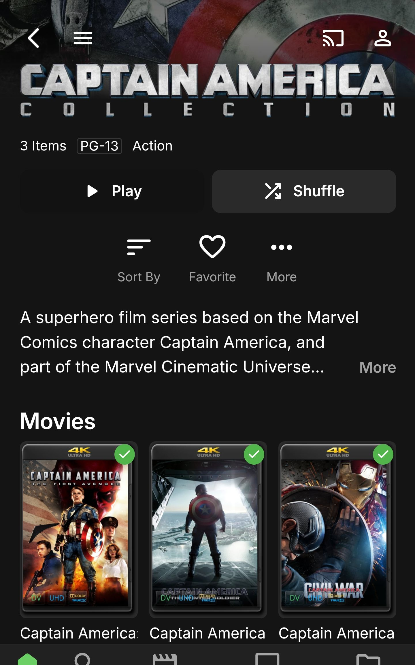

supermood 71 Posted May 21, 2024 Posted May 21, 2024 my new captain collection. there's something really wrong. I have 3 and in emby they are displayed correctly.
supermood 71 Posted May 21, 2024 Posted May 21, 2024 5 minutes ago, FrostByte said: Have you tried to refresh boxsets? thanks yes. In emby ecerything is correct. besides 15 are missing and it seems thees 15 are destroyed one I see in kodi. but not 100% sure yet. anyway in kodi I see 15 of more than 100 and they are not correct
