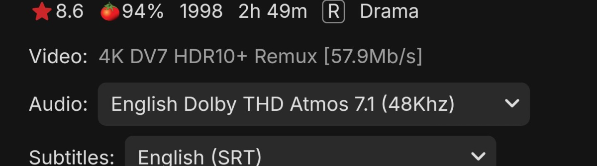

quickmic 1709 Posted May 15, 2024 Author Posted May 15, 2024 2 hours ago, supermood said: oh my, many thanks. So much to learn for me. I will try to understand it, and customize accordingly info, my understanding I have many info in kodi already, like dolby true HD. but I have the atmos and dtsx info in emby since yesterday with the plug in, it was not there before. also visible now is for example bit rate of audio track, or dv profile 7, like in the screenshot. all new. not possible in emby standard. these info are maintained in tags by that add on, im a bit sure because everyone was telling me and in emby I can now filter for the tags to see example all dv 7 movies in a poster wall... I'm not scraping anything with kodi, my libs are now perfect with emby management. I think thumbnails for chapter are on but honestly I've used an chapter for anything not sure I need that. but if it has some relevance here I leave it on of course... I'm using arctic zephire reloaded. it was recommended and it looks nice. that skin should be able to show tags, but maybe as text, I don't think there are these icons for atmos or dtsx like I have for dolby true HD.. but as I cannot check that tag option anyway, and you write I shouldn't, I will probably never now Rename a test file, pattern is "movie name (2019)(1080p).imax.hdr.10bit.atmos.mkv"

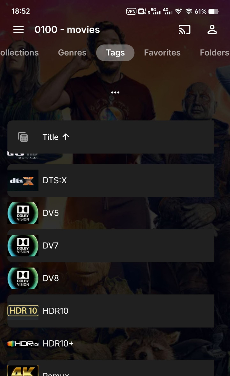

supermood 71 Posted May 15, 2024 Posted May 15, 2024 2 hours ago, quickmic said: Hold on, you mean Emby tags? I thought you meant the Kodi skin tags which are completely different case. yep emby movie Tags. I finally now have atmos and dts x etc information available in emby. or dv profiles. thanks to the add on. these info are missing without the add on. I see the tags and info in emby. I can work with the tags for filter dtsx movies for example. I cannot see the info kodi. not as tags, not as icons, not as info, not as text not as whatever... a movie in kodi is still true HD, even if the movie is atmos true HD
quickmic 1709 Posted May 16, 2024 Author Posted May 16, 2024 (edited) 7 hours ago, supermood said: yep emby movie Tags. I finally now have atmos and dts x etc information available in emby. or dv profiles. thanks to the add on. these info are missing without the add on. I see the tags and info in emby. I can work with the tags for filter dtsx movies for example. I cannot see the info kodi. not as tags, not as icons, not as info, not as text not as whatever... a movie in kodi is still true HD, even if the movie is atmos true HD Let's continue here, this might take longer... Edited May 16, 2024 by quickmic
