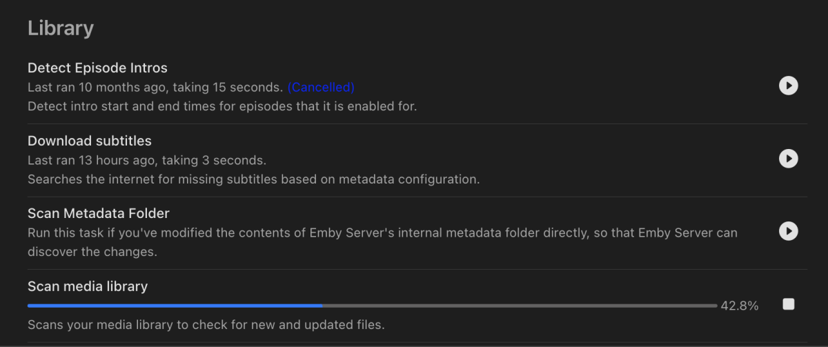

nobody01 89 Posted February 14, 2024 Posted February 14, 2024 So I recently have my metadata deleted, my fault and not having a backup I can use. 1) Is there a way to see outstanding fingerprinting? Like actual Episodes left? 2) Is there a way to not fingerprint an item? 3) I have fingerprinting enabled as Scheduled Task and when new media is added.... However even on a library scan it is seeming to scan through all my files. Backed by a cloud provider, I'm finding i'm getting API bans due to excessive downloads. Is there a way we can throttle the fingerprinting? Cheers,
Luke 42184 Posted February 14, 2024 Posted February 14, 2024 Quote 1) Is there a way to see outstanding fingerprinting? Like actual Episodes left? 2) Is there a way to not fingerprint an item? Hi, no both of these, although these would be good things to add. 1
Luke 42184 Posted February 14, 2024 Posted February 14, 2024 Quote 3) I have fingerprinting enabled as Scheduled Task and when new media is added.... However even on a library scan it is seeming to scan through all my files. Hi, how would you like to throttle, or what do you mean by that?
nobody01 89 Posted February 14, 2024 Author Posted February 14, 2024 57 minutes ago, Luke said: Hi, how would you like to throttle, or what do you mean by that? Limit the amount of files being processed by size? For example 10TB daily download limit but Emby can easily eat through that as the rate of episodes it pulls is super fast. I’d say a max download limit per day would be ideal. Doesn’t happen often but if thinking migration from Plex for example this can be a pain. a chap has written how to export the intro markers from Plex but it’s then matching those to the Emby ids per episode and then being confident it’s a match.
Luke 42184 Posted February 14, 2024 Posted February 14, 2024 Quote Limit the amount of files being processed by size? For example 10TB daily download limit but Emby can easily eat through that as the rate of episodes it pulls is super fast What I would suggest is configuring it to only run as a scheduled task. Then, there is no option to throttle based on size, but you can configure the schedule as desired and set a time limit on it. So for example having it run on an interval every 24 hours or at a specific time like 1am and then limiting the scheduled executions to X number of hours. You can probably come up with a limit of a number of hours that keeps the amount of data transfer reasonable.
nobody01 89 Posted February 15, 2024 Author Posted February 15, 2024 8 hours ago, Luke said: What I would suggest is configuring it to only run as a scheduled task. Then, there is no option to throttle based on size, but you can configure the schedule as desired and set a time limit on it. So for example having it run on an interval every 24 hours or at a specific time like 1am and then limiting the scheduled executions to X number of hours. You can probably come up with a limit of a number of hours that keeps the amount of data transfer reasonable. Thanks for the idea. Whats odd is the I deleted the scheduled run task within the Detect Episode Intros. When the scan library media is run it seems to be ignoring that and fingerprinting anyhow. 2024-02-15 03:00:03.183 Info MediaProbeManager: ProcessRun 'ffprobe' Execute: /bin/ffprobe -i file:"/data/media/tvshows/8 Out of 10 Cats Does Countdown/Season 25/8 Out of 10 Cats Does Countdown - S25E05 - Jon Richardson, Asim Chaudhry, Joe Wilkinson, Roisin Conaty, Lucy Pearman WEBDL-1080p.mkv" -threads 0 -v info -print_format json -show_streams -show_chapters -show_format -show_data 2024-02-15 03:00:03.183 Info EpMetaRefresh - TaskRefresh: Refreshing Metadata : (592113)(Blue Exorcist)(s03e06)(I Can't Rely On Anyone)(2024-02-11 00:00:00) 2024-02-15 03:00:03.185 Info MediaProbeManager: ProcessRun 'ffprobe' Execute: /bin/ffprobe -i file:"/data/media/tvshows/Blue Exorcist/Season 3/Blue Exorcist - S03E06 - I Can't Rely On Anyone WEBDL-1080p.mkv" -threads 0 -v info -print_format json -show_streams -show_chapters -show_format -show_data 2024-02-15 03:00:03.185 Info EpMetaRefresh - TaskRefresh: Refreshing Metadata : (592137)(Ancient Aliens)(s20e05)(The Top Ten Alien Codes)(2024-02-09 00:00:00) 2024-02-15 03:00:03.185 Info MediaProbeManager: ProcessRun 'ffprobe' Execute: /bin/ffprobe -i file:"/data/media/tvshows/Ancient Aliens/Season 20/Ancient Aliens - S20E05 - The Top Ten Alien Codes WEBDL-1080p.mkv" -threads 0 -v info -print_format json -show_streams -show_chapters -show_format -show_data 2024-02-15 03:00:03.185 Info HttpClient: GET https://api4.thetvdb.com/v4/series/395985/episodes/official?page=0 2024-02-15 03:00:03.186 Info EpMetaRefresh - TaskRefresh: Refreshing Metadata : (592169)(Love Island All Stars)(s01e27)(Episode 27)(2024-02-10 00:00:00) 2024-02-15 03:00:03.186 Info MediaProbeManager: ProcessRun 'ffprobe' Execute: /bin/ffprobe -i file:"/data/media/tvshows/Love Island - All Stars/Season 1/Love Island All Stars - S01E27 - Episode 27 HDTV-1080p.mkv" -threads 0 -v info -print_format json -show_streams -show_chapters -show_format -show_data 2024-02-15 03:00:03.186 Info EpMetaRefresh - TaskRefresh: Refreshing Metadata : (592188)(The Masked Singer (UK))(s05e07)(Episode 7)(2024-02-10 00:00:00) 2024-02-15 03:00:03.188 Info MediaProbeManager: ProcessRun 'ffprobe' Execute: /bin/ffprobe -i file:"/data/media/tvshows/The Masked Singer (UK)/Season 5/The Masked Singer (UK) - S05E07 - Episode 7 WEBDL-1080p.mkv" -threads 0 -v info -print_format json -show_streams -show_chapters -show_format -show_data 2024-02-15 03:00:03.189 Info EpMetaRefresh - TaskRefresh: Refreshing Metadata : (592189)(Love Island All Stars)(s01e27)(Episode 27)(2024-02-10 00:00:00) 2024-02-15 03:00:03.197 Info MediaProbeManager: ProcessRun 'ffprobe' Process exited with code 0 - Succeeded 2024-02-15 03:00:03.199 Info HttpClient: GET https://api4.thetvdb.com/v4/series/395985/episodes/official?page=0 2024-02-15 03:00:03.330 Info MediaProbeManager: ProcessRun 'ffprobe' Execute: /bin/ffprobe -i file:"/data/media/tvshows/Love Island - All Stars/Season 1/Love Island All Stars - S01E27 - Episode 27 HDTV-1080p.mkv" -threads 0 -v info -print_format json -show_streams -show_chapters -show_format -show_data 2024-02-15 03:00:03.330 Info EpMetaRefresh - TaskRefresh: Refreshing Metadata : (592200)(Married at First Sight (AU))(s11e09)(Episode 9)(2024-02-11 00:00:00) 2024-02-15 03:00:03.452 Info HttpClient: GET https://api4.thetvdb.com/v4/series/395985/episodes/official/eng?page=0 2024-02-15 03:00:03.488 Info MediaProbeManager: ProcessRun 'ffprobe' Process exited with code 0 - Succeeded 2024-02-15 03:00:03.488 Info MediaProbeManager: ProcessRun 'ffprobe' Process exited with code 0 - Succeeded
Luke 42184 Posted February 15, 2024 Posted February 15, 2024 18 minutes ago, jaketame said: Thanks for the idea. Whats odd is the I deleted the scheduled run task within the Detect Episode Intros. When the scan library media is run it seems to be ignoring that and fingerprinting anyhow. 2024-02-15 03:00:03.183 Info MediaProbeManager: ProcessRun 'ffprobe' Execute: /bin/ffprobe -i file:"/data/media/tvshows/8 Out of 10 Cats Does Countdown/Season 25/8 Out of 10 Cats Does Countdown - S25E05 - Jon Richardson, Asim Chaudhry, Joe Wilkinson, Roisin Conaty, Lucy Pearman WEBDL-1080p.mkv" -threads 0 -v info -print_format json -show_streams -show_chapters -show_format -show_data 2024-02-15 03:00:03.183 Info EpMetaRefresh - TaskRefresh: Refreshing Metadata : (592113)(Blue Exorcist)(s03e06)(I Can't Rely On Anyone)(2024-02-11 00:00:00) 2024-02-15 03:00:03.185 Info MediaProbeManager: ProcessRun 'ffprobe' Execute: /bin/ffprobe -i file:"/data/media/tvshows/Blue Exorcist/Season 3/Blue Exorcist - S03E06 - I Can't Rely On Anyone WEBDL-1080p.mkv" -threads 0 -v info -print_format json -show_streams -show_chapters -show_format -show_data 2024-02-15 03:00:03.185 Info EpMetaRefresh - TaskRefresh: Refreshing Metadata : (592137)(Ancient Aliens)(s20e05)(The Top Ten Alien Codes)(2024-02-09 00:00:00) 2024-02-15 03:00:03.185 Info MediaProbeManager: ProcessRun 'ffprobe' Execute: /bin/ffprobe -i file:"/data/media/tvshows/Ancient Aliens/Season 20/Ancient Aliens - S20E05 - The Top Ten Alien Codes WEBDL-1080p.mkv" -threads 0 -v info -print_format json -show_streams -show_chapters -show_format -show_data 2024-02-15 03:00:03.185 Info HttpClient: GET https://api4.thetvdb.com/v4/series/395985/episodes/official?page=0 2024-02-15 03:00:03.186 Info EpMetaRefresh - TaskRefresh: Refreshing Metadata : (592169)(Love Island All Stars)(s01e27)(Episode 27)(2024-02-10 00:00:00) 2024-02-15 03:00:03.186 Info MediaProbeManager: ProcessRun 'ffprobe' Execute: /bin/ffprobe -i file:"/data/media/tvshows/Love Island - All Stars/Season 1/Love Island All Stars - S01E27 - Episode 27 HDTV-1080p.mkv" -threads 0 -v info -print_format json -show_streams -show_chapters -show_format -show_data 2024-02-15 03:00:03.186 Info EpMetaRefresh - TaskRefresh: Refreshing Metadata : (592188)(The Masked Singer (UK))(s05e07)(Episode 7)(2024-02-10 00:00:00) 2024-02-15 03:00:03.188 Info MediaProbeManager: ProcessRun 'ffprobe' Execute: /bin/ffprobe -i file:"/data/media/tvshows/The Masked Singer (UK)/Season 5/The Masked Singer (UK) - S05E07 - Episode 7 WEBDL-1080p.mkv" -threads 0 -v info -print_format json -show_streams -show_chapters -show_format -show_data 2024-02-15 03:00:03.189 Info EpMetaRefresh - TaskRefresh: Refreshing Metadata : (592189)(Love Island All Stars)(s01e27)(Episode 27)(2024-02-10 00:00:00) 2024-02-15 03:00:03.197 Info MediaProbeManager: ProcessRun 'ffprobe' Process exited with code 0 - Succeeded 2024-02-15 03:00:03.199 Info HttpClient: GET https://api4.thetvdb.com/v4/series/395985/episodes/official?page=0 2024-02-15 03:00:03.330 Info MediaProbeManager: ProcessRun 'ffprobe' Execute: /bin/ffprobe -i file:"/data/media/tvshows/Love Island - All Stars/Season 1/Love Island All Stars - S01E27 - Episode 27 HDTV-1080p.mkv" -threads 0 -v info -print_format json -show_streams -show_chapters -show_format -show_data 2024-02-15 03:00:03.330 Info EpMetaRefresh - TaskRefresh: Refreshing Metadata : (592200)(Married at First Sight (AU))(s11e09)(Episode 9)(2024-02-11 00:00:00) 2024-02-15 03:00:03.452 Info HttpClient: GET https://api4.thetvdb.com/v4/series/395985/episodes/official/eng?page=0 2024-02-15 03:00:03.488 Info MediaProbeManager: ProcessRun 'ffprobe' Process exited with code 0 - Succeeded 2024-02-15 03:00:03.488 Info MediaProbeManager: ProcessRun 'ffprobe' Process exited with code 0 - Succeeded Please remove the EpMetaRefresh plugin and restart the server and then re-evaluate. I don't know exactly what the plugin does, so once it's removed it may take a couple library scans to get back to normal.
nobody01 89 Posted February 15, 2024 Author Posted February 15, 2024 4 minutes ago, Luke said: Please remove the EpMetaRefresh plugin and restart the server and then re-evaluate. I don't know exactly what the plugin does, so once it's removed it may take a couple library scans to get back to normal. Gotcha - That is refreshing metadata for recently released episodes that may not have metadata on the source cause its just been released. I will disable and give the library a few scans to see what happens. Thanks 1
