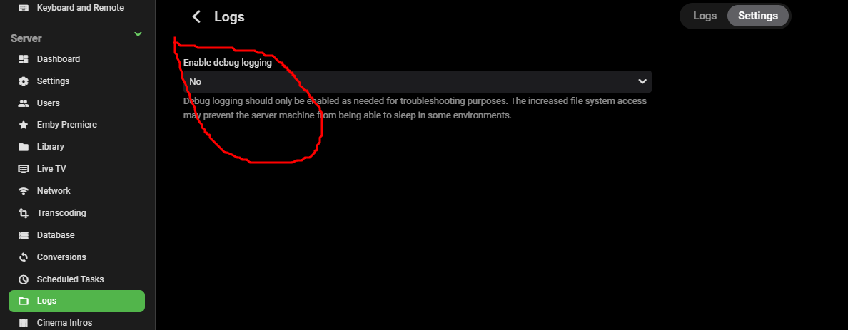

Neminem 1623 Posted February 14, 2024 Posted February 14, 2024 (edited) Yes i can access api4.thetvdb.com. But I do not use vpn, turn it off and try again. If that works, lookup split tunneling and if your vpn provider supports that. Edited February 14, 2024 by jaycedk

Neminem 1623 Posted February 14, 2024 Posted February 14, 2024 Guess all those errors quickly fill up you logs, with or without debug enabled. 1

HumanMusic 2 Posted February 14, 2024 Author Posted February 14, 2024 44 minutes ago, jaycedk said: Did you enable this. No, I'm not
