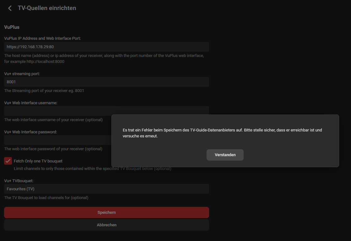

tomadick 8 Posted February 16, 2024 Author Posted February 16, 2024 It is also possible that it is a LAN problem. I have now tried to connect the Dreambox via VUplus Plugin, but I also get the error message.... In addition, only the first channel is recognized when reading the m3u from the Dreambox - all other channels do not appear in Emby. Screenshot and m3u attached, HDplus.m3u
Luke 42241 Posted February 18, 2024 Posted February 18, 2024 On 2/16/2024 at 2:02 PM, tomadick said: It is also possible that it is a LAN problem. I have now tried to connect the Dreambox via VUplus Plugin, but I also get the error message.... In addition, only the first channel is recognized when reading the m3u from the Dreambox - all other channels do not appear in Emby. Screenshot and m3u attached, HDplus.m3u 8.53 kB · 1 download Hi @tomadick, maybe the url is unreachable? The server log will help answer that: How to Report a Problem Thanks.

pünktchen 1411 Posted February 20, 2024 Posted February 20, 2024 On 2/16/2024 at 8:02 PM, tomadick said: It is also possible that it is a LAN problem. I have now tried to connect the Dreambox via VUplus Plugin, but I also get the error message.... Https will not work with port 80. The url should start with http://
pünktchen 1411 Posted February 20, 2024 Posted February 20, 2024 On 2/16/2024 at 8:02 PM, tomadick said: In addition, only the first channel is recognized when reading the m3u from the Dreambox - all other channels do not appear in Emby. It's probably because all channels in your m3u have the same tvg-id, so Emby thinks they are all the same.
