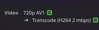

ZanderKeen 73 Posted January 29 Posted January 29 9 minutes ago, SamES said: Thanks, do they all have issues with AV1 playback? Are they all trying to DirectPlay? @SamES Actually just testing them now, on both models, they are now being transcoded server-side. Server is running version 4.9.3.0 ATV clients running version 2.0.3 (2) No flickering or display problems that were previously occurring now that transcoding is happening on the server. I did update the server to the current stable version when that released at some point after reporting this issue. 1

darkrom 5 Posted January 29 Author Posted January 29 46 minutes ago, ZanderKeen said: @darkromhave you tried to see if the issue is fixed for you on the latest stable server version as well? It seems to be working after testing the initial file I used as an example. There was a little stutter 2x when it first started playing, then worked just fine after that. Thank you! 1 1
