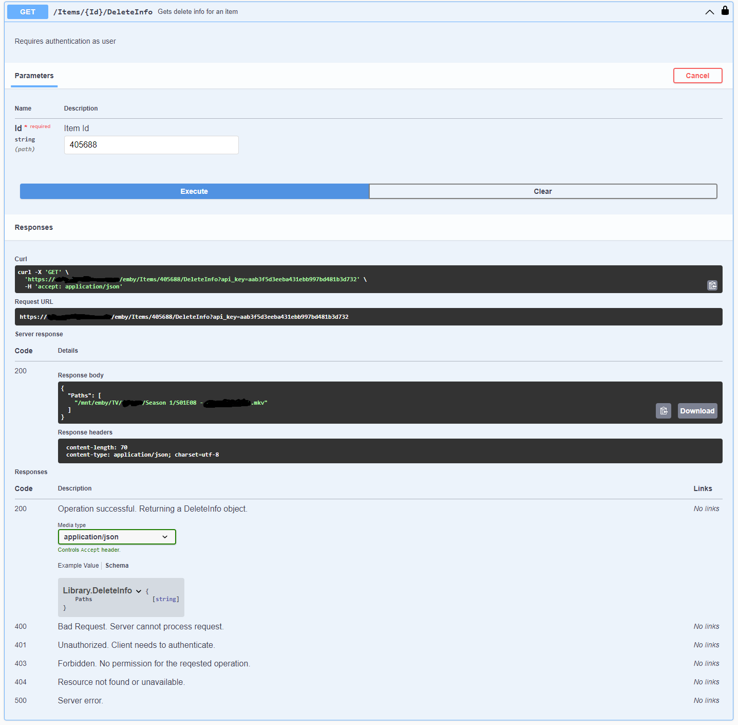

artstar 17 Posted May 1, 2024 Posted May 1, 2024 Also, to add some more food for thought, I've tried another call and I can demonstrate how this works for Swagger but not a local curl execution. First, locally: 2024-05-01 20:59:33.963 Debug Server: http/1.1 GET http://[redacted]/Items/405688/DeleteInfo?api_key=e16bfdd4c29b4ba8bd54f334f4721afd. UserAgent: curl/7.81.0 2024-05-01 20:59:33.964 Debug SqliteItemRepository: GetitemById Episode 405688 /mnt/emby/TV/[redacted]/Season 1/S01E08 - [redacted].mkv 2024-05-01 20:59:33.964 Error Server: Error processing request *** Error Report *** Version: 4.8.5.0 Command line: /opt/emby-server/system/EmbyServer.dll -programdata /var/lib/emby -ffdetect /opt/emby-server/bin/ffdetect -ffmpeg /opt/emby-server/bin/ffmpeg -ffprobe /opt/emby-server/bin/ffprobe -restartexitcode 3 -updatepackage emby-server-deb_{version}_amd64.deb Operating system: Linux version 5.15.0-101-generic (buildd@lcy02-amd64-032) (gcc (Ubuntu 11.4.0-1ubuntu1~22.04) 11.4.0, GNU ld (GNU Binutils for Ubuntu) 2.38) #111-Ubun Framework: .NET 6.0.25 OS/Process: x64/x64 Runtime: opt/emby-server/system/System.Private.CoreLib.dll Processor count: 2 Data path: /var/lib/emby Application path: /opt/emby-server/system System.ArgumentNullException: System.ArgumentNullException: Value cannot be null. (Parameter 'user') at MediaBrowser.Controller.Entities.BaseItem.GetShareLevel(User user) at MediaBrowser.Controller.Entities.BaseItem.CanDelete(User user, Folder[] collectionFolders) at Emby.Api.Library.LibraryService.Get(GetDeleteInfo request) at Emby.Server.Implementations.Services.ServiceController.Execute(HttpListenerHost appHost, Object requestDto, IRequest req, Type serviceType) at Emby.Server.Implementations.Services.ServiceHandler.ProcessRequestAsync(HttpListenerHost httpHost, IServerApplicationHost appHost, IRequest httpReq, IResponse httpRes, IStreamHelper streamHelper, RestPath restPath, String responseContentType, CancellationToken cancellationToken) at Emby.Server.Implementations.HttpServer.HttpListenerHost.RequestHandler(IRequest httpReq, ReadOnlyMemory`1 urlString, ReadOnlyMemory`1 localPath, CancellationToken cancellationToken) Source: MediaBrowser.Controller TargetSite: MediaBrowser.Model.Dto.UserItemShareLevel GetShareLevel(MediaBrowser.Controller.Entities.User) 2024-05-01 20:59:33.964 Info Server: http/1.1 Response 400 to [redacted]. Time: 1ms. GET http://[redacted]/Items/405688/DeleteInfo?api_key=e16bfdd4c29b4ba8bd54f334f4721afd Then, Swagger:
artstar 17 Posted May 1, 2024 Posted May 1, 2024 Just now, amateurgod said: I would redact your API Keys from the logs btw, I know you redacted the IP/FQDN but to be safe you should redact the API key too Nah, it's safe. This Emby server is strictly LAN. No WAN access into it and my entire network is barricaded from incoming internet on my Fortigate.
