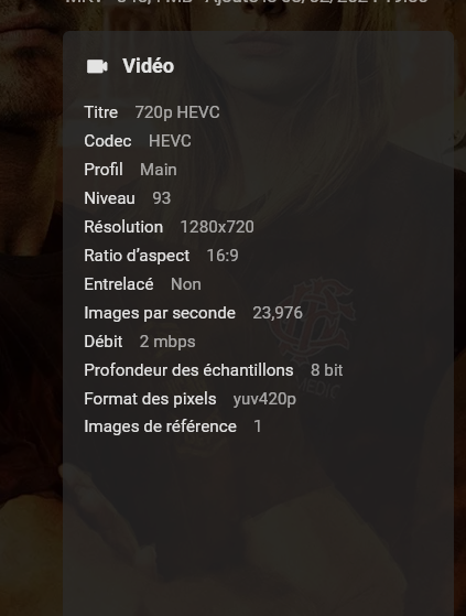

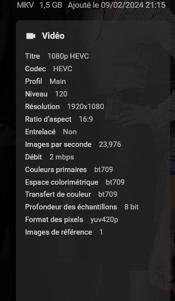

Delafuentedelfuego 3 Posted February 9, 2024 Posted February 9, 2024 Hi, I realize that my conversions in Emby (really very practical) do not take into account the choice of the selected bitrate. When I select convert to --> MKW --> HEVC --> "Custom" quality and enter a value (eg 3) it converts everything to 2Mbs and not 3 as selected. In addition, I specify that the source always has a higher bitrate (between 5 and 10 in H264). Can you help me or explain to me? Thank you in advance for your immense work!
Luke 42184 Posted February 9, 2024 Posted February 9, 2024 Hi, what makes you think it doesn’t take into account the selected bitrate?
Delafuentedelfuego 3 Posted February 9, 2024 Author Posted February 9, 2024 Hi, Library display. I chose a 3Mbs file and ended up with 2 everywhere.

Luke 42184 Posted February 11, 2024 Posted February 11, 2024 On 2/9/2024 at 3:22 PM, Delafuentedelfuego said: 21:16:57.388 Stream #0:0: Video: h264 (High), cuda(tv, bt709, progressive), 1920x1080 [SAR 1:1 DAR 16:9], q=2-31, 4940 kb/s, 23.98 fps, The value you selected is the total bitrate for the whole file. Your screenshot is only showing 2 mbps for the video stream, but there must be audio inside that file? Possibly even subtitles. All of those things have bitrates. Does this answer your question?
