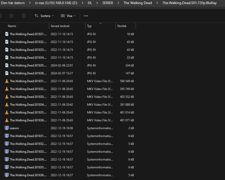

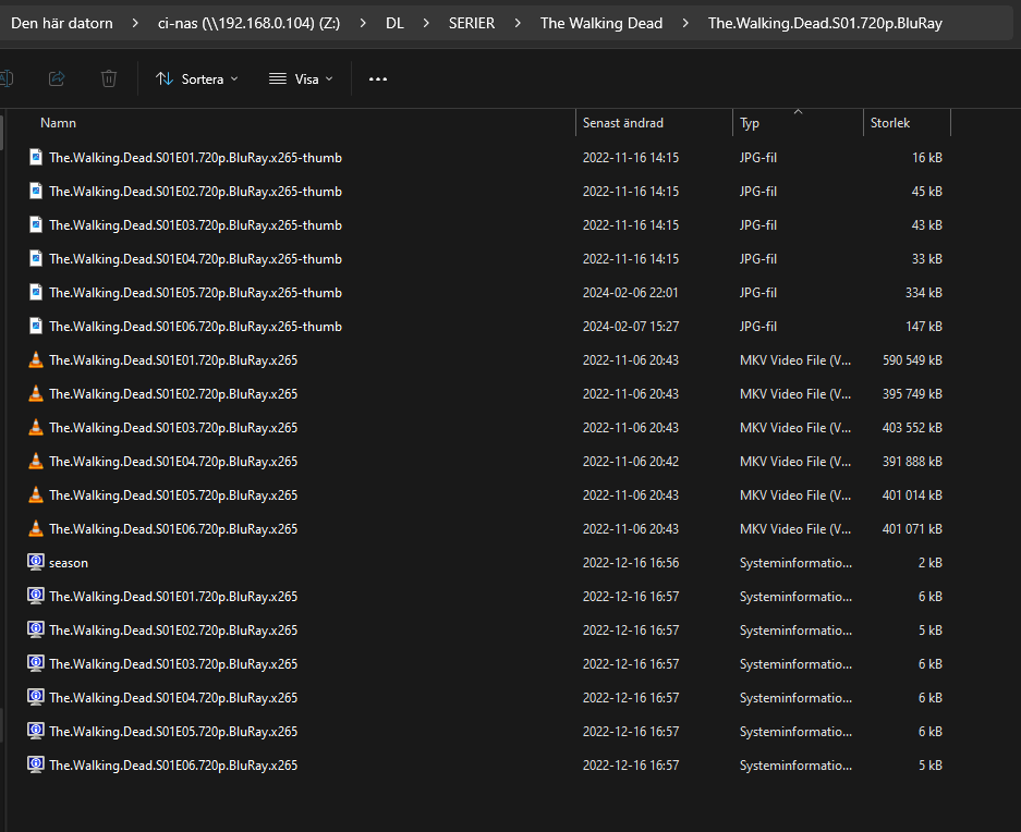

metuo 2 Posted February 8, 2024 Author Posted February 8, 2024 Sure, they look as below, yes, i have tried with no success,
Luke 42184 Posted February 8, 2024 Posted February 8, 2024 Can you please expand the columns so that the complete names are visible? Thanks. 1
Happy2Play 9799 Posted February 8, 2024 Posted February 8, 2024 Would have to testing here but will guess it is choking on the Season folder. 1
metuo 2 Posted February 8, 2024 Author Posted February 8, 2024 (edited) I changed season folder names to just S01 and so on which seems to work better, i'll tidy up my library with a better structure. Thank you @Lukeand @Happy2Play for very fast responses. Edited February 8, 2024 by metuo 1 1
