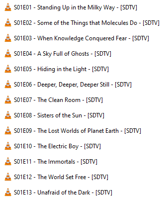

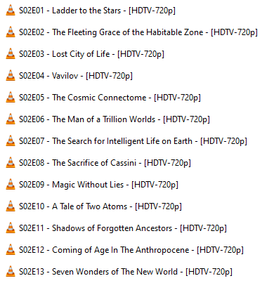

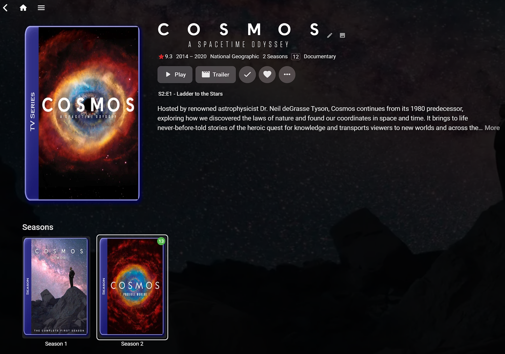

pgriffith 88 Posted February 8, 2024 Posted February 8, 2024 (edited) My Cosmos is fine, all in one folder with 2 seasons. See image, and pics of my files from the Season 01 & 02 folders Edited February 8, 2024 by pgriffith Typo
