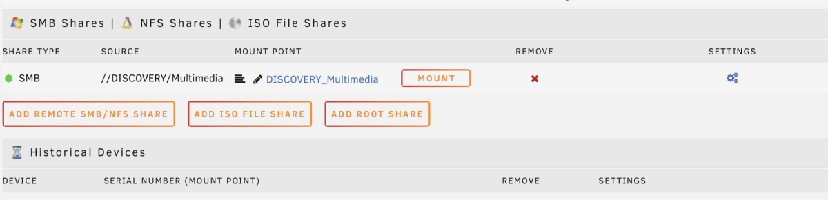

RobbieBott 5 Posted February 8, 2024 Author Posted February 8, 2024 (edited) 1 hour ago, jaycedk said: Out of curiosity why are you mounting your media via smb ? When running Unraid, why not direct from share in unraid ? I transfer the movie from my Mac to the Unraid storage share via SMB. I have two Unraid servers, one is storage (R710 no/terrible GPU support), while the other (Dell Optiplex) has a GPU for transcoding and better performance. Unraid on the transcoding server is mapped to the storage server shares via Unassigned devices plugin. The Emby docker container path is mapped to /mnt/RemoteShares/etc... So Emby thinks it's just another share like normal. It's the same way I run Plex. So I figured Emby would function the same. Is that incorrect? Edited February 8, 2024 by RobbieBott

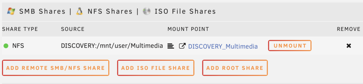

Neminem 1623 Posted February 8, 2024 Posted February 8, 2024 (edited) What happent in you map that share to nfs using Unassigned devices. Or make a new share using nfs, so you dont disturbe plex. Edited February 8, 2024 by jaycedk
RobbieBott 5 Posted February 8, 2024 Author Posted February 8, 2024 37 minutes ago, jaycedk said: What happent in you map that share to nfs using Unassigned devices. Or make a new share using nfs, so you dont disturbe plex. Same thing. Adding a movie file to the share does not trigger Emby.
Luke 42244 Posted February 8, 2024 Posted February 8, 2024 NFS might not work with it. Emby uses the dotnet runtime, which in turn uses INotify for this function, and if I recall I don't think that supports nfs.
RobbieBott 5 Posted February 8, 2024 Author Posted February 8, 2024 1 minute ago, Luke said: NFS might not work with it. Emby uses the dotnet runtime, which in turn uses INotify for this function, and if I recall I don't think that supports nfs. It was on SMB, but I moved it to NFS based on the previous recommendation. I can move it back to SMB to further troubleshoot if you could provide me a starting point.
RobbieBott 5 Posted February 8, 2024 Author Posted February 8, 2024 Yes I can change that mount back to SMB. This is how it was originally configured.
