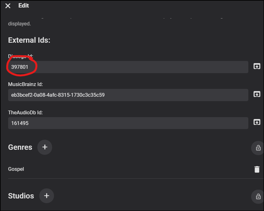

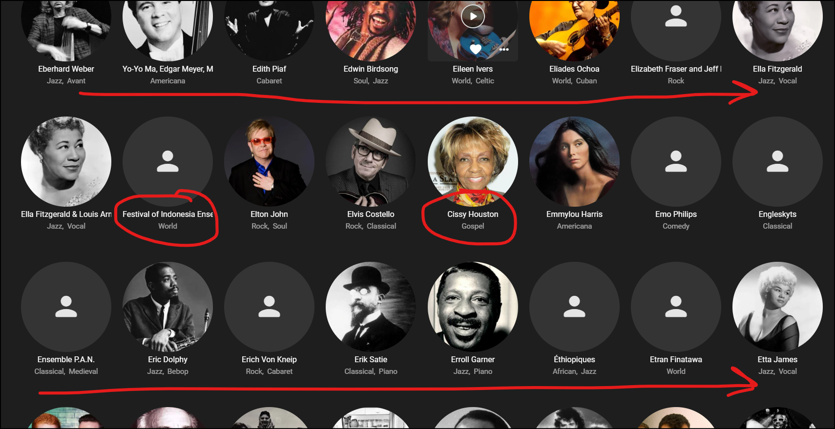

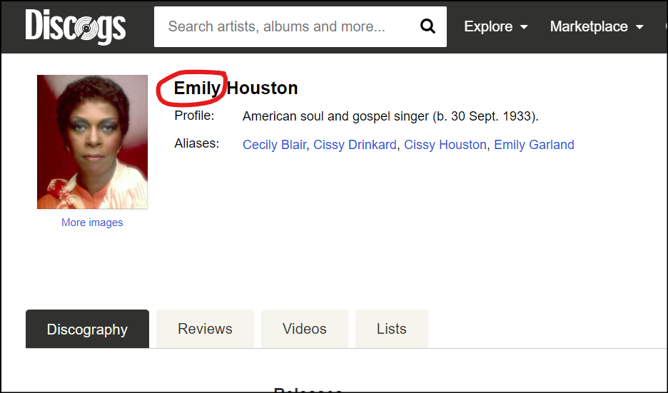

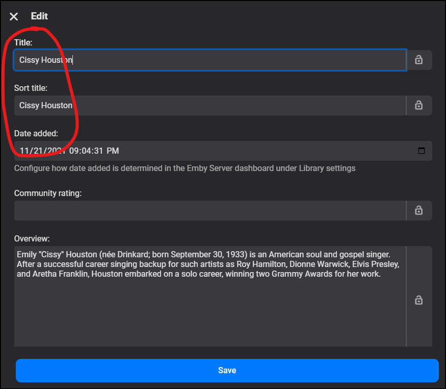

nospotify 186 Posted February 8, 2024 Posted February 8, 2024 Music Library sorting is still operating inconsistently. See this screen from Album Artists, sorted by "Title" (as an aside: can't Emby devs change this to "Name"!?). You'll see there are some weird outliers, like Cissy Houston in the middle of the mostly properly alphabetized/sorted "E" entries. So I looked at the metadata, which shows both Title (i.e. Album Artist) and Sort Title are correct, with no reason for this Album Artist to appear in the middle of the "E" section. Then I scrolled down and thought to check the external providers: : Then I checked what's on Discogs, and they have her listed with birthname, which is what is obviously messing things up, and prompting Emby to sort her as "E." When I delete the Discogs ID and hit 'save', the Cissy Houston entry instantly jumps to its proper location among the "C"s, with no changes having been made to embedded metadata. Ta da! So to summarize, Emby is prioritizing Discogs over embedded data (although weirdly not doing the same with MusicBrainz or TheAudioDB, because I didn't delete either of those IDs, and sorting worked properly once the Discogs ID was deleted). Emby is displaying embedded Sort Title but using actually using different metadata to do its sorting on, and I don't think this isn't how Emby should operate. (Please don't suggest "uncheck Discogs" because it should be used to retrieve missing metadata.) Emby should operate so that visible "Sort Title" is what is actually, you know, used for sorting, and sorting priority should be in descending order using actual embedded data first, and then (only if embedded metadata doesn't exist), down through the external services, in the order set up in Library settings. External providers should be used to retrieve missing embedded metadata, but not prioritized above actual embedded metadata. I could swear this was discussed months ago, and Luke said "good idea, Emby should operate that way" but I can't find the thread here. Regardless, can this fix be made easily?
